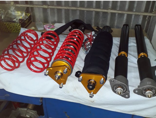

Thanks for the info, can you write down the name of your shocks? I would like to check them out.
Also can you please describe if more/less compression or more/less rebound makes the car more comfortable?
Protlum - custom made.
More compression will not make the car more uncomfortable.
Just extremely big changes in the more direction.
You will feel better response at cornering (but you will loose grip on gravel or minor bumps)
Rebound changes make main comfort changes.
