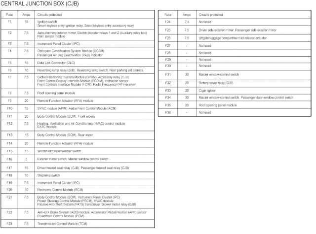

Fuse for "Cigar Lighter" circuit is 20A.

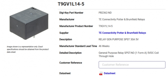

Selected 5v SPST-NO Non-Latching relay. Coil will consume 180mA of available USB power. Contacts are 30A rated.
DigiKey Search Results - Link1
Relay Ordered from DigiKey -
https://www.digikey.com/en/products/detail/T9GV1L14-5/PB2362-ND/8345122?itemSeq=386187231

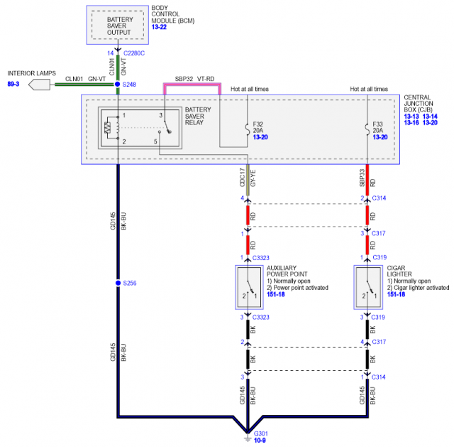

Even with the radio turned off, it keeps its USB ports active until the Accessory Delay (presumably R9 Relay) disables the power windows, rear outlet, interior lights, etcetera. The Accessory Delay is triggered either by timer or when the driver door is opened; whichever comes first. Once the Accessory Delay is triggered, the radio begins switching the USB ports on/off, as the radio is switched on or off. The USB ports are reactivated as soon as a door triggered. This gives the radio the head-start it needs to boot and index the USB drive's content. If the radio is shutdown again (by closing the door) the USB ports are shutdown with it.
Since the front 12v Outlet for my 2016 is Hot-At-All-Times, this will be my circuit setup.
3,659
2,262
Finally got my wiring diagrams to work; had to reinstall the Adobe SVG component.
For whatever reason the installer from the disc no longer installs it automatically; must look on the disc and install it manually.

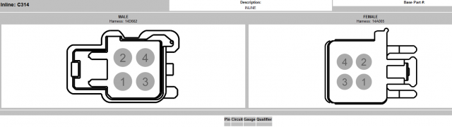

This shows why the Auxiliary Outlet in the rear turns on/off while the front stays hot-at-all times.
The wire is red. But following C314 junction it will match color with the switched outlet. So I will need to test and confirm which red wire needs to be cut and routed through the relay.
No specific detail for the USB ports on Sync 3. But it's likely that the only difference is, they were relocated to being inside the console, away from the "cigar lighter".

The relay I selected...
