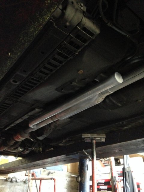

Mine is 2.5" pipe t'd into a 3" system. The larger the diameter of the side-branch resonator, the broader the effective range of attenuation. There are a few pics of how mine fits on that other thread, it curls back on itself like a trombone or trumpet to fit it all in the muffler cavity. If I had a muffler in the stock location, no idea how I'd ever fit the side-branch.
To find your drone range, double-blind it. First, drive around and identify the RPM where the drone feels the worst - usually the MOST obnoxious point for a FiST is 3200rpm, with a curve down on either side of that range. (If you're getting more attenuation at 3800rpm, its possible your exhaust is touching the body somewhere, probably the mid chassis brace, and it makes the body of your car into a resonator like the body of a guitar). After you identify where the drone feels worst, then do some recordings using a spectrum analyzer app on your phone. Inside the car it might peak at 120hz because of secondary resonance, but if you do several recordings and average them you'll likely find your peak at ~3200.

I like how you did that on your custom exhaust version. Now you got me looking for a local exhaust shop! Yet another reason I wish I had a welder.
I bought a welder to do this stuff, but once I realized I'd need the car on a lift to get it all to fit right anyways I decided to just pay my normal fab guy to do it. You can take a pic of my exhaust to give them an idea of what you want to do.
I was toying with the idea of building MBRP-specific rear sections for a while to sell, but it's not cost-effective at small volume. Instead I just put the "how-to" documentation out here :p
If it wouldn't get him sued by MBRP I'd bet ron could make a "MBRP-drone fix kit" but that's suuuuuuper niche, I doubt many would buy it. I sent my info to MBRP too, but I have a feeling it just went into a nameless corporate inbox and was discarded.
