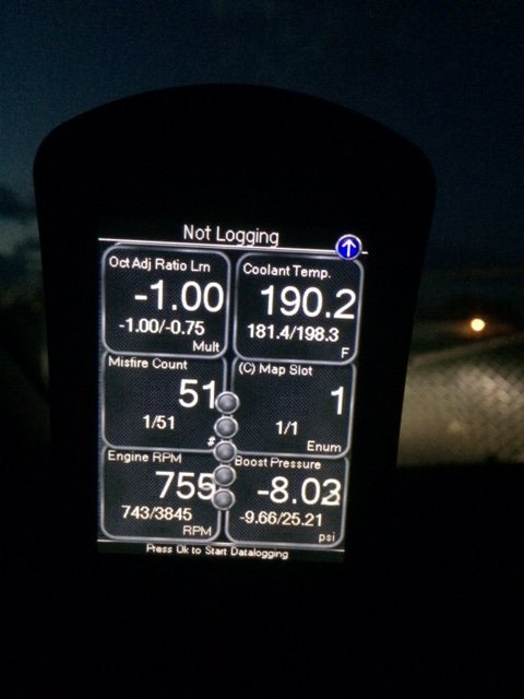

Hello everybody,
I was bored and decided to mess with the AP a little and changed some parameters to display up on the AP. So I found the setting for Misfire Count and thought hey what the heck it may be worth it to keep tabs on this. In the old days misfires meant something was not good/right. After doing a 90 mile round trip yesterday on my 91 stage 2 tune it started bugging me seeing well over 100 misfires for the entire trip. This morning did the same route dropping the wife early on for her shift and I decided to change the maps back to my E30 tune and loaded in the e85 to proper mixture, I still got quite of few misfires as show in the picture it was quite a few but roughly half as many as I had with the 91 tune.
Now the big question is this of any concern, should I be worried or should I be looking to change out some things??
I am running the step colder plugs that came pregapped by whoosh. Tunes are by dizzy as well.

anybody out there have any input on the misfire in the ap I still get shitloads of misfire counts but do they mean anything serious? I replaced plugs with pregapped ones just in case and it made no diff so far still get up to 100 misfire counts driving 60 miles. even tried switching maps to cobb stage 2, dizzy e30 and 91 really made no diff still just racks up counts like in the pic.

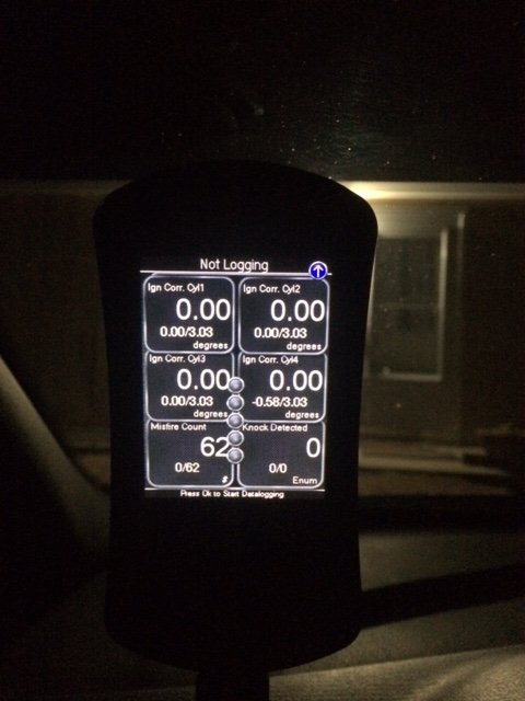

definitely helps great info I only got one negative correction on cyl #4 during a 60 mile drive I did today IMG_0290.JPG

don't really know how bad that correction is but I suppose I can pull the plug tomm and double check it its pretty new though only been in there 2 months and I replaced the last set after 10k just because I didn't know better.

ok so the pattern is becoming clear it only does negative corrections on cylinder #4 every time I drive it is the only one that gets the - correction/ 1-3 never gets a - correction. now to find what is actually causing it. If it was bad gasoline wouldn't I be seeing - corrections across all cylinders??? either way seems like the issue is with #4
