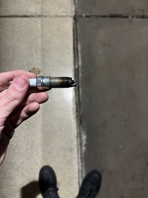

Update: checked the spark plug on cylinder 1. Looks like it’s wet, possibly oil, this mean I’d have to change out the PCV valve correct?
I’m not sure what you need to replace, but what if you put a new plug in cylinder 1 and see if that temporarily stops the misfire?

if the dealership won't service the car they aren't much of a dealership. Or shysters who knowingly sold a car with problems. Especially if they are telling you it needs a new engine because they knew it had a cracked head or something.
That said, if you're going to work through the problem yourself, you actually need to make a diagnosis, which is what the dealership's service department should have done. There are plenty of cars which oil-foul plugs that can be repaired. The most common reason is a malfunction in the PCV system. To look further, I'd look at all four spark plugs. Consider compression testing the engine, especially if only one plug is oiled. Check the oil for coolant contamination.
If the plugs are all fouled, it may be the PCV. It can also be a blown turbo seal.
