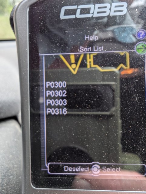

Those are all just misfire codes. Misfiring is not surprising, given that diesel fuel doesn't burn like gasoline does.
It was bad when the diesel went in the fuel tank. Correct action to take at that time would have been to NOT start the engine and to drain the fuel tank, rinse the diesel out of it, then flush the fuel lines to remove any diesel.
At this point you could have a number of things wrong besides just fouled plugs, which you certainly do have. Fuel injectors, fuel filter can be clogged, catalytic convertor damaged, or more.
You need to stop running the engine and get all the diesel out of the fuel system and replace any damaged components. Diesel and gas generally don't mix, and even if they appear to initially, the diesel separates.
The codes are from after the diesel was pumped out via hotwiring the fuel pump and replacing with fresh gasoline. I took the intake apart and there is a lot of oil everywhere. New spark plugs were used for the codes.
I am wondering if something happened to the turbo and it puked oil in the intake and now the intake valves are caked with carbon.

I wish, the FiST is the only vehicle I have that is gasoline, everything else I have is diesel. I must have somehow put diesel in a gas can and forgot about it.
Damn man, that sucks. Unfortunately Steve is probably spot on that you’re going to have a multitude of problems to address.
