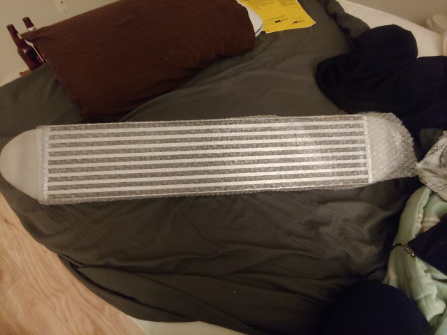

I bought mine from alibaba for 150 dollars
Thanks.... but Im not looking for cheap alibaba/ebay one offs. Maybe they are as good as the models that cost 2X as much... maybe not. Id rather go with the 2X as much model now, then learn I guessed wrong and then buy the 2x as much model I should have bought to begin with, and repair the issues the cheaper model has caused because I didn't...... Im looking for a reputable value, from a reputable manufacturer. I'd rather "buy once and cry once" like Typhoon Fist said... Just cry as little as possible for a modest needs.
