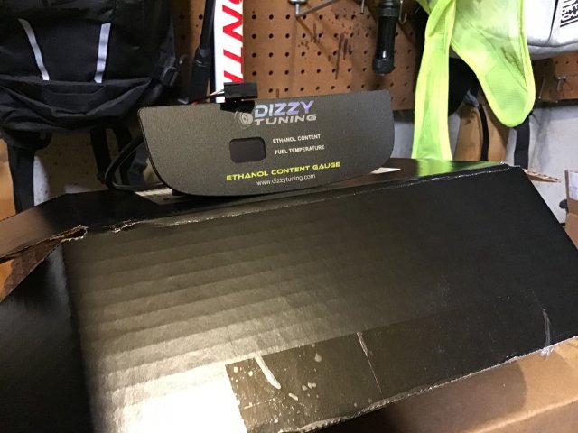

Dizzy Ethenol Gage

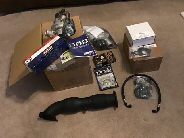

waaaaay over my head so it won’t be me, lol. I think with the hpfp’s out there everyone will go what route Now, though they are really pricey. I just ordered the whole sha-bang in a moment of weakness. Having thought about it a bit more I’m just not going to push for the limits so the S280 outta be good.

yea, agreed. I had that very conversation with Jason (Dizzy). I was asking with 340 or so without the crazy boost levels. Some of these dudes pushing 30+...respect man, but damn, lol. I dunno, if the aux don’t sell I may end up installing it. It would be used rarely versus all the time to reduce risk of a mechanical issue. The occasional call out lol.
