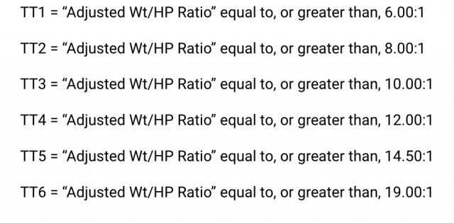

If you become interested in Tarmac stuff, NASA AZ is pretty active and looks like they will be going to multiple tracks. Your car would likely be in either TT4 or TT5 class.
That sounds like a lot of fun! As the car sits now, it makes 280WHP on 91 octane. Before the cage it weighed 2337. I will call the cage 120 pounds. That is 2457 pounds for a result of 8.775:1.
Is that TT2 or TT3 by rule? I read that "or greater" to mean TT3 since it is *greater than 10:1 but less than 8:1. Is that right?
For fun, 400WHP would be 6.14:1! My contact at Mountune thinks that is realistic on race gas with bigger injectors and a new DI pump. It is not necessarily a goal for me, however. I value good power with as close to "bullet proof" as possible instead. So 280WHP on 91 would make me happy if it achieved it without issue.
WannabeST
645
856
Riverside,CA
#40
You are correct, it sounds like you would be a lot close to TT3. There is also modifiers in the rulebook to adjust depending on what tire you are running and we get a small benefit for being FWD and etc. But yes you are definitely going to be classed higher than I anticipated. I did not realize how light your car was.
