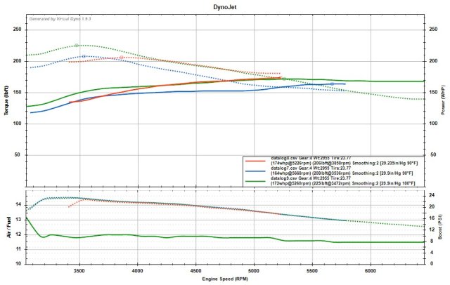

I dusted off the old Accessport recently to monitor coolant temps, and noticed I was only seeing around 22 PSIG peak boost. I don't recall how it ran 6 years ago, but I was expecting more like 25 PSIG. WGDC was pegged out at ~85% the entire time. Threw the data log in vdyno and it came back with 174hp, which also seems low. Here's the log:

I'll upload my most recent data log when I get home, but on a dizzy stage 2 91 tune , my VDyno showed 176whp and 232wtrq here in the desert with 100⁰ ambient. So yours might not be far off, my max boost was just under 24psi
