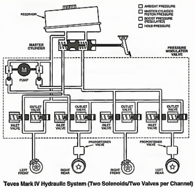

Why the module would be intermittently interfering with braking when it's not even powered does sound really strange. After looking up more info on the internal construction of the ABS modulator, it becomes apparent that there was some physical problem with an internal valve.
https://www.repairsmith.com/blog/abs-module/
Yes, agreed on 'some physical problem with an internal valve', thanks for the diagram and the link. It's been fine for many months now.
