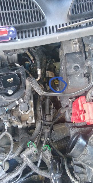

I just got back from a drive to see how shifting felt. Shifting was definitely smoother than before and it's easier to quickly go into gear. I highly recommend this if you're having shifting issues. I followed the video that I linked above and had no issues with my clip breaking.
The blue circle shows the clip that you need to pop off.
