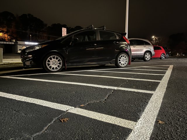

I have 205/45/16s. Stock springs with bilstein shocks. I really like that size but I see how they could look a little small.
