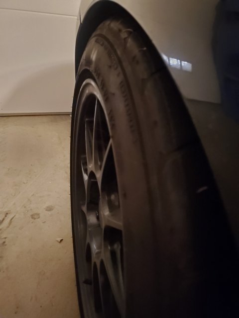

My 205/50r16 re71r don't have much stretch on an 8" rim. (Tried to get a good pic of the angle but it's hard to get a shot that's representative because the bead (?) of the tire protrudes out past the edge of the rim)
