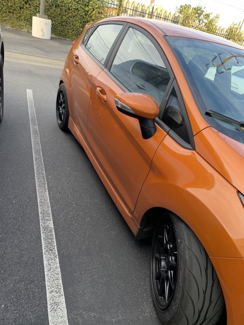

Thread Starter #46
Yeah, some have also claimed that the Yellow coil overs will go to factory ride height as well, but I want/need a setup that can go to .75" to an inch HIGHER THAN the stock ride height if needed, front AND back. [wink] [:(]
IF I go with a coil over setup over a Bistein B6 on new factory springs, it will probably be the soon to be released, Panda Motorworks exclusive, Silver NeoMax gravel rally spec suspension, with some higher rate, but shorter height, Swift springs on them, set to a factory ride height. [driving]
BTW, there is only ONE tuner shop around here who will even put a 205/50-16 on a 16x8 (for a substantial 'extra charge' of course [mad]), and NONE of the online places that I've asked will do this at all.
So between that, the stretch which is NOT wanted for the bombed-out roads around here, and a bit more wheel edge protection, I will go with a set of STRONG 16x7s with the requisite for my cold ambient temp capable locale, UHP all season 205/50-16s on them, since this setup will NEVER see a road course, or an autocross course.

Thanks for everyone's input, decided to go with BFG SC2 for a few reasons:
1. Availability
2. Local shop feedback
3. Price.
4. Contact patch width
1. Aside from the local Firestone dealer, I couldn't readily get the size I needed in the Indy
2. Literally every shop I called for quotes between the three contenders, all recommended SC2.
3. Firestone shop quoted me almost $600 out the door, even with the black Friday sale. I got America's tire to honor a $70 mail in rebate from a competitor, I paid $437.99 out the door for the SC2. (Don't think I did too shabby there. 😁)
4. Decided to go with the widest tread width option (8"). It's basically a 225/41r16. (Look at 225/45r16 direzza's - tread width of 7.9"!!) I went with a wider rim, tried the stretch already, so I figured I'd try a wider tire this time around.
Thanks again!!
