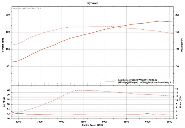

Still scratching my head a bit. On the first rev with 40% WGDC, I hit peak boost and then fall by 3 psi by redline. No change in WGDC - holds flat at 40% the whole way. Spooling late as well. Here's a VDyno to show what boost is doing and the accompanying data log.
Can't find a ton of data logs others have posted but those that I can find seem to hold boost steady all the way to the rev limiter.

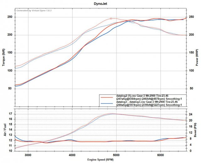

Quick update.. On 3rd map from Jason 65% WGDC. Peak boost is sweet right at 25 psi but falls off to 20 psi by redline. 5.16.21 VDyno.jpg
