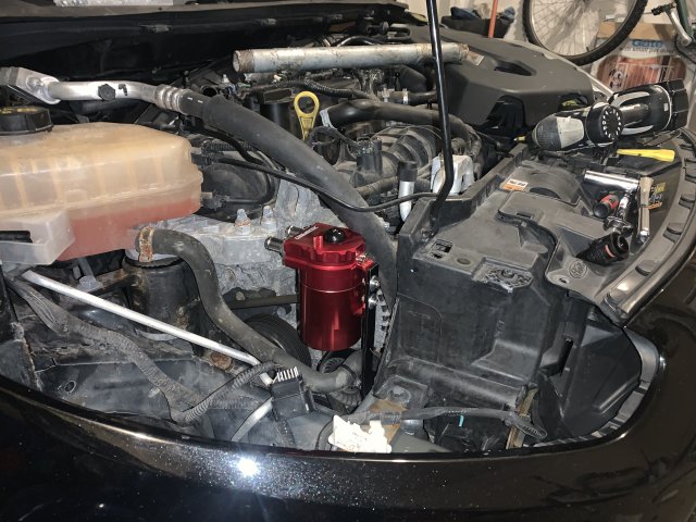

running Damond OCC with air breather option since 2015 and never gotten a CEL, i had extended the drain oil line to close to the subframe and i just drain it every 5000 miles when i change oil

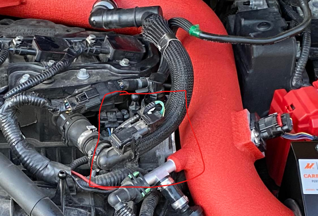

I don't run that can, but I've done battle with that code recently. If you are connecting directly from the can to the drain hole on the crankcase, that will be the problem. There is a sensor on the OEM hose. When I looked at the website for a picture of the radium crankcase can, it looks like a smooth silicon hose all the way to the crankcase. Not sure about all model years, but on my 2016 I had to keep the OEM hose with the sensor connected and hack the silicon hose to the end that connected to my new intake. Once I did that, the code disappeared.
