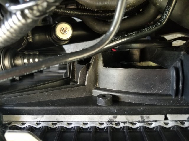

I have read dozens of overheating threads occurring after a tune. Its because you blocked off the radiator with your new bar and plate intercooler not because the tune is "hot". I have had an e30 Dizzy tune for over a year in the 100 degree Florida heat sitting in traffic running my ac on max with my stock radiator and never overheated once...of course I have a Mountune Intercooler (tube and fin style). The kind the car war designed and tested for. Additionally I have weather stripped the radiator shroud with some Home Depot stripping to maximize flow through the fins when the fans kick on. I used to have a Sentra Spec V which I put a turbo on, and it would overheat when sitting in traffic with a Koyo radiator, so I went about trouble shooting. First Koyo racing radiator, then high performance Spahl fans then weather stripped the shroud. The last one did the trick so i know it definitely helps. 20200513_103424.jpg

I've seen a few members also post about filling in those gaps. I haven't had any overheating issues yet but would like to look at doing the same. Don't know much about weather stripping, any advice on what size, thickness etc works well? I am checking youtube to see if there are any videos on it now.

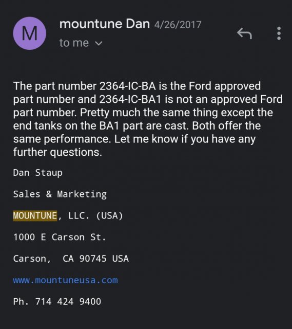

My original question:
Hello, wondering if you can tell me the functional differences between 2364-IC-BA and 2364-IC-BA1? Is one more suitable than the other for use in support of the Fiesta MRX turbo?​
Their answer:

Maybe the bit in the description is an artifact from the previous iterations. They list the BA1 part number on the intercooler only page, and BA2 on the intercooler kit page, too. Probably just sloppy version control/housekeeping on their website.
At any rate, it looks like they have had 3 versions of the intercooler. How did this turn into a mountune archeology thread? lmao
