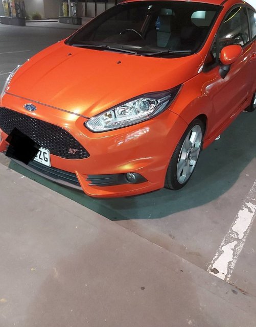

My St has had cooling issues. Goes into limp mode but with no dashboard communication.
I've had my solenoid valve and thermostat replaced - had an at home computer diagnostics not find any fault codes. We get the car upto operating temp when it decides not to push through any coolant. Concerned it may have a cracked head. mechanic had trouble bleeding the system when replacing the overflow coolant reservoir.
I'm looking at having to go to my ford dealership to spend 300 aud just for them to look at it... any tips? I'm close to just limping the car into a ditch at this point.
Ford says my vin is outside the recall issue... are they playing dodgy or is it just terrible timing?
