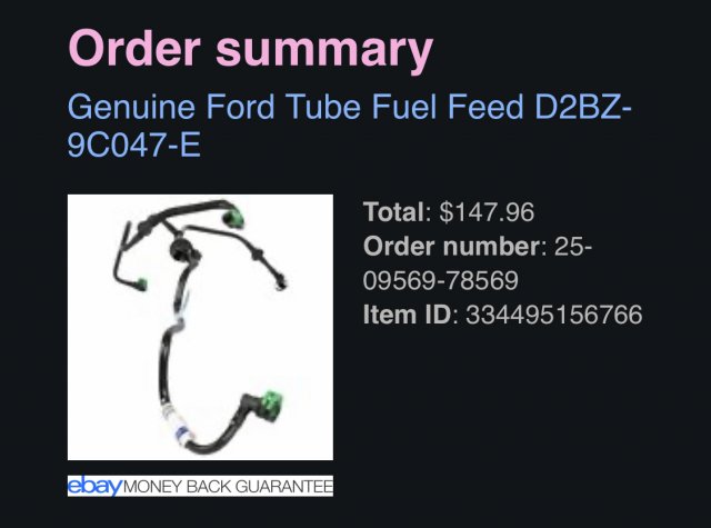

Hey thank you I believe I purchased at the last time judging by the picture and one tube to the air intake. I think I found what I was looking for on eBay and unfortunately it’s $100 more like everyone else paid
AngryOrange
10
11
Rocky Point, NY, USA
This is what I think I needed Sorry I meant the part number ends in an “E”. The part number ending in “F” didn’t have the second vacuum inlet hose going to the air inlet pipe for my year
