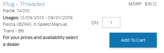

Does anyone have a part number for the transmission drain/fill plug ?
When changing the fluid this weekend one got mangled in the process.

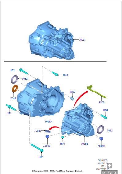

Ford Parts website: Looks like 7A010
https://parts.ford.com/shop/en/us/plug-threaded-7834497-1
It looks like a somewhat generic part number. Plugging it into other websites yields various shapes and sizes of plug. I recommend taking this part number to your local dealer to get the right one or look it up on the Ford Parts website to get it there (after entering the proper transmission model, the B6.) I could not find the part on Tasca's site.

Thank you Sir! That's just what I needed.
