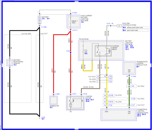

Hi I have a 2016 FIST,
I just changed the timing belt and i get no power to the starter cable unless i jump it. Aka no voltage to the relay.
Is it the fuse box or the PCM? I dont know.
Would you know the pin or have the pin diagram for this so I can check for resistance?

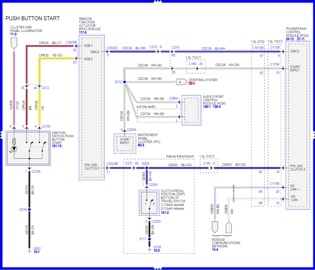

This is not quite like troubleshooting the old cars.
There's chatting between modules and security (aka PATS) involved.
Make sure it's reading the clutch pedal as down.
Place the key up to the steering column before beginning and during the crank.
Look at the display for yellow exclamation point indicating a message.
Circumstantially the messages can flash so quick they get missed.

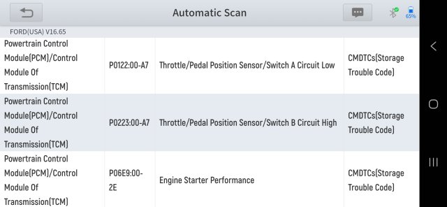

What codes are present?
There may be a very good reason why the PCM says 'no cranky'.
Find out what that is, first.
If needed I can provide a wiring diagram.
I'm guessing looking at the trouble code(s) will point us in the right direction and negate a need for the diagram.

Battery is fine, there should be voltage at the starter relay at all times right? This comes direct from the battery fuses? There is 0 voltage at just that.
Rockauto sold me a pos that has created a nightmare. Note the starter cables were bot hooked up as well as the intake manifold. 1000037397.jpg
