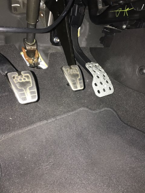

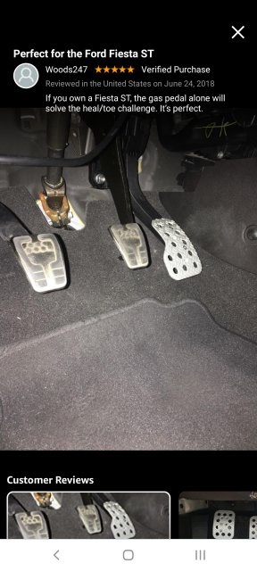

Anyone have a tutorial for changing out the pedals? My feet have slipped off the standard pedals while wet. I was hoping it was just a few screws to swap the pedals. I’ve seen some nice sparco ones for ~$40 on Amazon
If you look at the Amazon review photos, it looks like someone unbolted the stock pedal and drilled/bolted this one in. I haven't looked at the stock pedal so can't say for sure. It's Woods so maybe you can PM him.

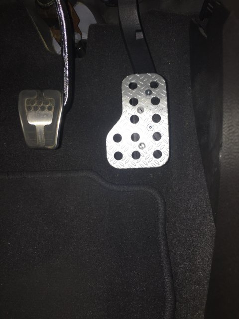

Yeah that’s me. I was originally going to change all three faces but the throttle pedal was all I needed. I removed the OEM metal cap (it’s easiest if you remove the pedal from the car), put the pedal back in the car, put the new pedal face where I wanted it and marked two holes for the mounting bolts. It’s easier to do than you might think. I couldn’t use the spacers most guys buy. They’re extremely awkward on a track and actually caused my calf to cramp after long days. A wider throttle pedal face was the easiest solution. I still love it.
You can see the bolts in this pic. It’s been fine..
So is there drilling involved? For $47 I def wanna pull the trigger bc they look awesome. Was hoping it was just unscrew and rescrew as ignorant as that sounds.

You have to drill two small holes through the plastic OEM pedal.
