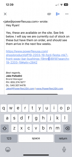

Funny story. I actually had a set from Powerflex... turns out PF failed on the design for the 14-15 models using 19mm sway bars. The bushing is too tall and will not fit under the stock brackets, and PF doesn't supply new brackets. So I emailed PF the problem and they're acutally working on a new bushing design for us folk with early gen USDM fiesta.

Yes! Powerflex confirmed they have them available. I'll check my email communications to see if I can get any more specifics. Was kinda irritated they didn't wanna hook me up with a set after basically helping them open up a market for the older gen fiesta owners, and also having a bunk design... but whatev.
So? What have you gathered?
