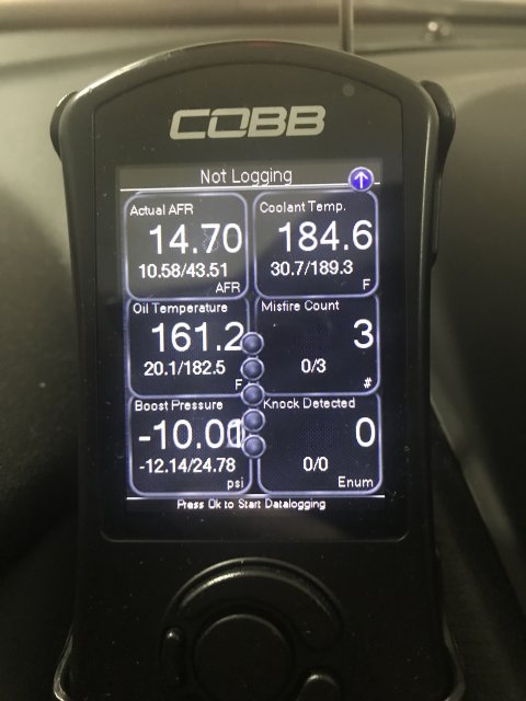

No boost leak tester but we can figure out some kind of smoke lol. I guess the only information I can offer is the AFR is slightly rich at idle once warm and then corrects to 14.7 down from 14.2 which seems pretty normal. Car is rich under boost hitting sometimes 10.5-10.88 AFR even under light boost low 11’s at times. When car cold starts it’s first at mid 15’s AFR then calms down to 14’s and stays there. All seems like symptoms of a boost leak after the sensors. Also during spool I believe I can hear a leak almost like a high pitch tea kettle.

We do have an air compressor so I could pick up a tester if I end up needing it after the couplings. Do we have an accessport monitor that shows AFR adjustment? Like AFR learning in subarus? Also could you briefly school me on why it’s okay for our cars to misfire?

Every car will misfire some* it just depends on how the manufacturer has setup up the threshold for the misfire counter to trip the Check engine light*
