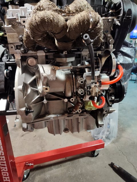

Header wrap for exhaust manifold since all the Cerakote flaked off (downpipe already wrapped)

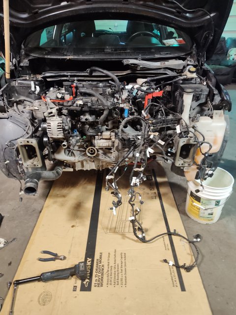

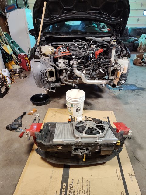

Thread Starter #65

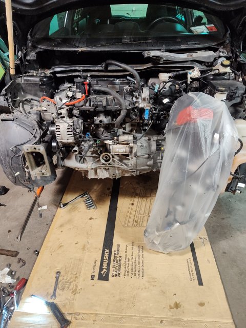

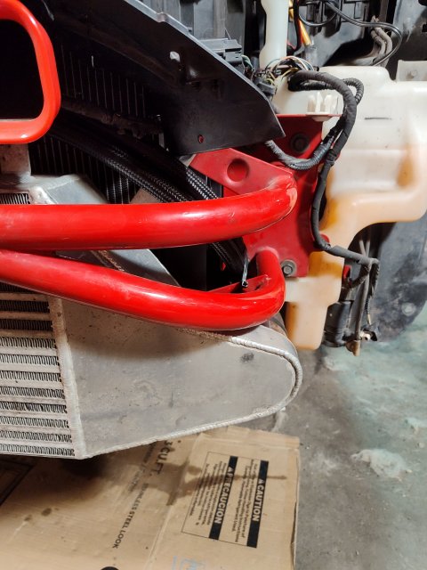

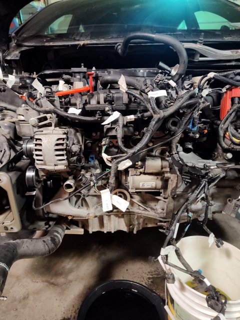

As long as it stays reasonably dry, should be getting stayed on the teardown/engine swap this weekend. I think I have acquired all the "while I'm in there" things I want/need to do for now.

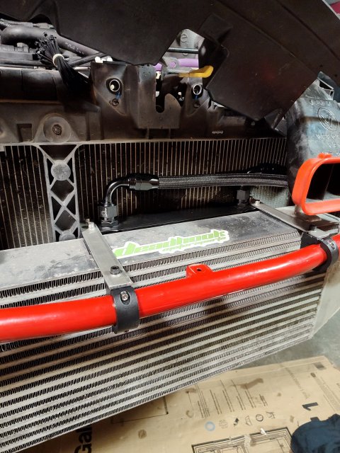

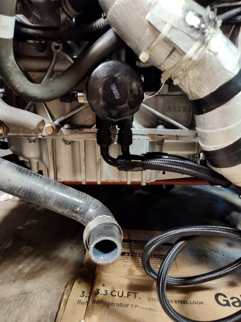

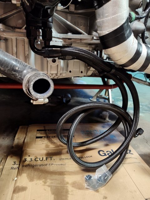

Along with the new engine, I'm adding in an Airtec oil cooler, which I will have to somewhat custom mount because of my setup (DHM intercooler and crash bar). Likely placing it center in front of the intercooler, going to remove my front license plate mount (will just zip tie the plate on if/when I'm on the street), and going to put some speed holes in the bumper cover section between the upper and lower grills (grilles?) for a little more air flow. Got a thermostatic sandwich plate with two 1/8" NPT ports from Chase Bays (Airtec one doesn't have auxiliary ports) so I can add in an oil temperature and an oil pressure sensor. Got a Glow Shift dual temp/pressure gauge/sensor combo and will put the gauge in the vent pod (will be right below my AP). I'm more worried about having to do minor wiring than I am yanking the engine. haha

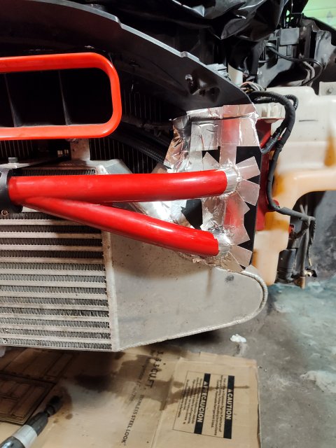

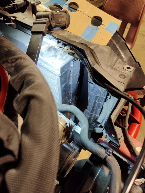

Got some ABS sheet and some foil duct sealing tape to try my hand at fully enshrouding the grill (grille?) openings and cooling stack for more efficient cooling. Never had an overheating issue prior to the engine popping (Mishimoto radiator and A/C deleted), but beefing up the cooling now so if/when I go ethanol later I can turn the dial up without worrying too much about it.

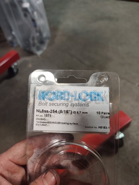

Also going to try some Nord Locks (paired serrated washers) on the turbo to manifold studs since on track my S280 keeps trying to fall off even with copper locknuts. I threw some Hotlock (ceramic loctite type stuff) on there last year and it seemed to work for 2 of the 3 studs, but I did have to snug the rear one every 2-3 sessions, which isn't hard, just inconvenient. Hoping the combo of ARP studs/nuts and Nord Locks sorts this.
Other stuff is just some basic clean up and maintenance. Got new spherical upper bearings for my BC coil overs as one has been blown out for ~2 years. Finally pinpointed the clunk last spring when I pulled the coil overs out and the passenger side upper bearing flopped like a fish, at which point I channeled my inner VGG and just said "I'm going to pretend I didn't see that" and just put it back in. haha

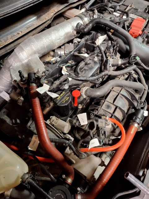

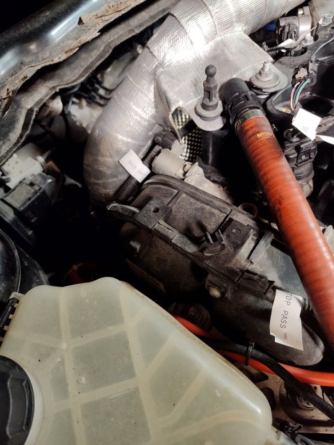

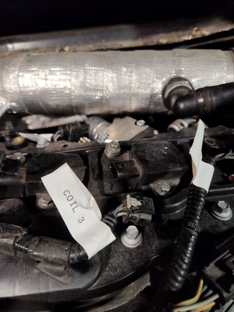

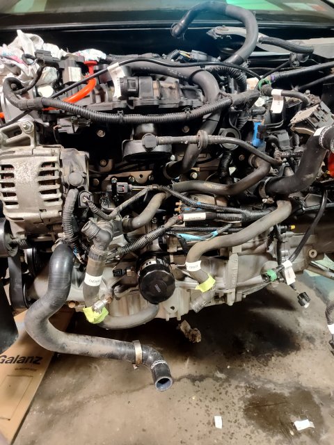

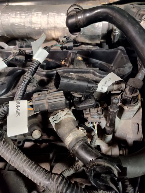

I'll remind myself to take pictures as I go. I also got a label maker to label all the wires/connectors/hoses as they are everywhere.
My somewhat firm deadline for getting everything swapped and ready to roll is around April 20th or so, to be able to fairly easily get the 1st 1,000 break in miles done before my dyno tuning session on May 11th. The minimum is 1,000 but I'm going to try to get as many miles and I can before then.
If anyone has anything specific they want me to look at or get a picture of while I'm elbow deep in the engine bay, let me know.

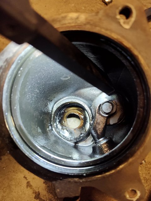

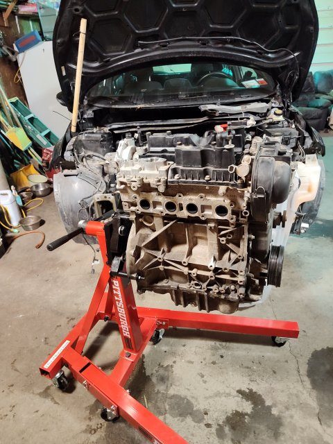

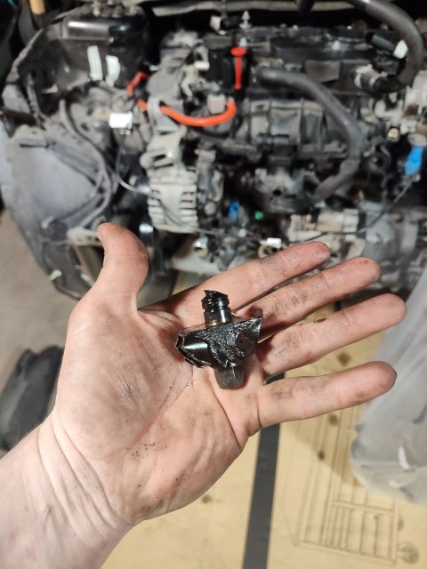

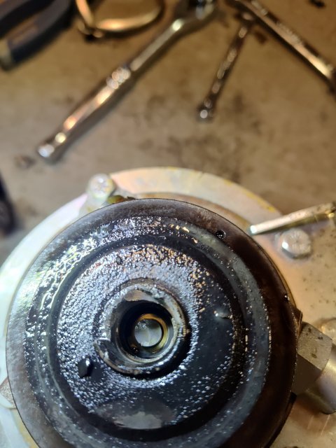

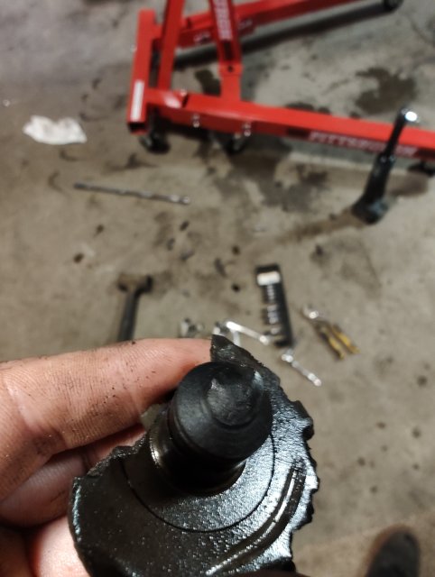

Found this in my downpipe.
Apparently my s280 exploded.
Suspect my downpipe is cooked as well, I can probably get all the oil out, but the cells are pretty beat up from the turbine wheel impact at what I can only assume was an insane speed.

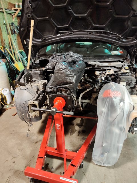

Engine and transmission will be out tomorrow. I have pictures of the process I'll get uploaded later on.

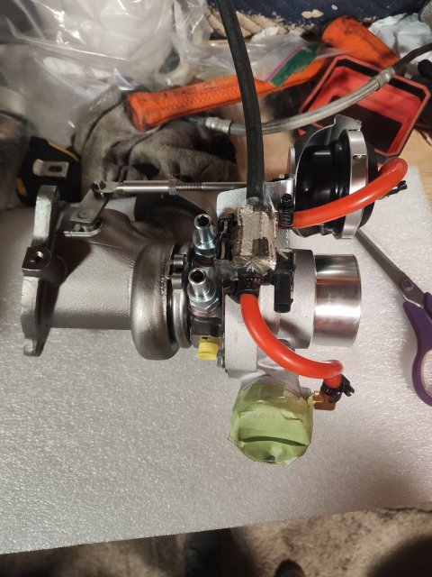

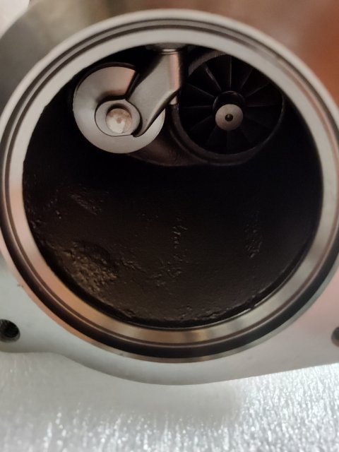

Other than oil in the exhaust (which will eventually burn off) it doesn't appear to of hurt anything else aside from itself and the downpipe. The compressor side is still like new and rotates perfectly and doesn't have any endplay or wobble, so I'm unsure as to why the shaft sheared on the turbine side. Best guess right now is that it lost a blade, became unbalanced, touched the turbine housing at warp 10 then launched itself into oblivion/the cells of my cat. Looking at the part, the turbine/shaft are either cast or sintered, so its possible there was an inclusion or some porosity beneath the surface that eventually caused the failure. Looked back through my log book and this turbo only had ~4,000 miles on it.

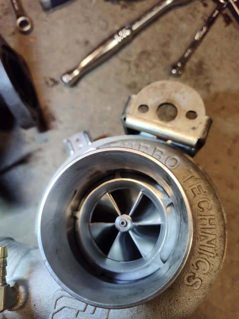

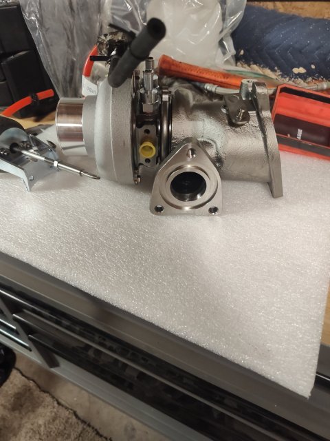

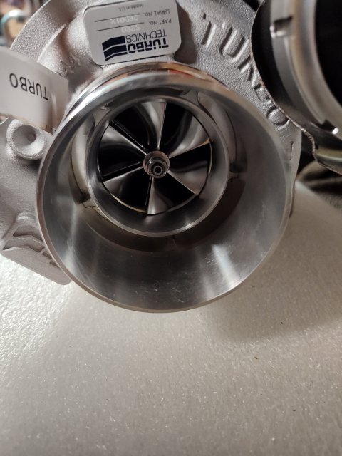

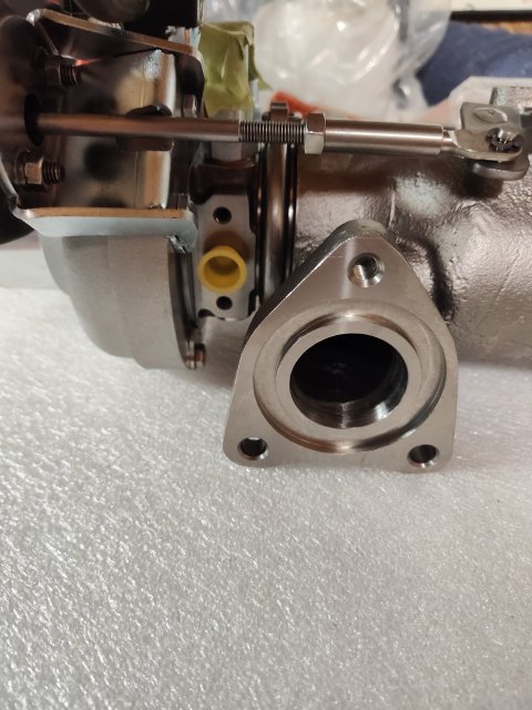

Have a new bare turbo on order straight from Turbo Technics as I don't need the full kit, which seems to be all we can get domestically.
Engine seems to be alright, but the built one is still going in either way.

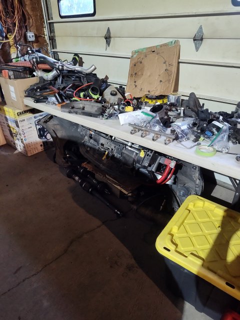

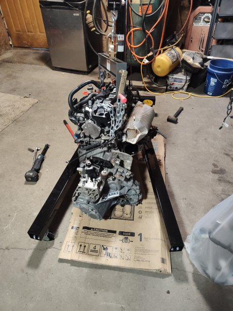

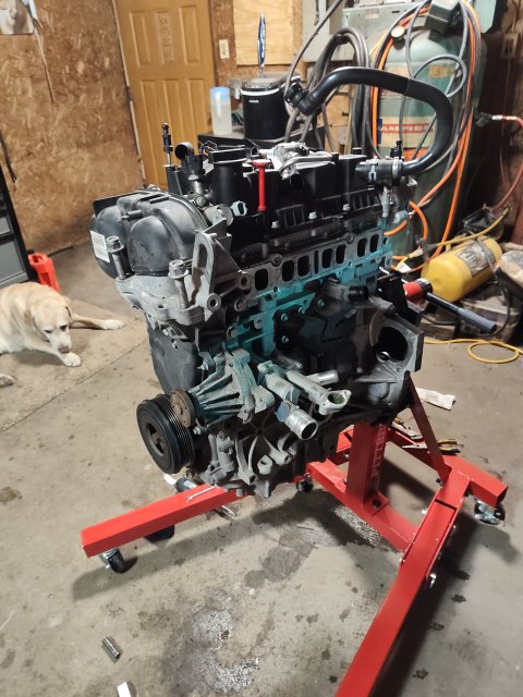

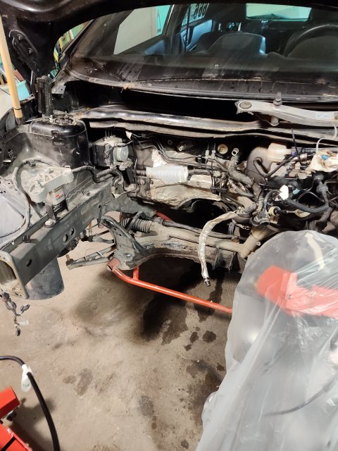

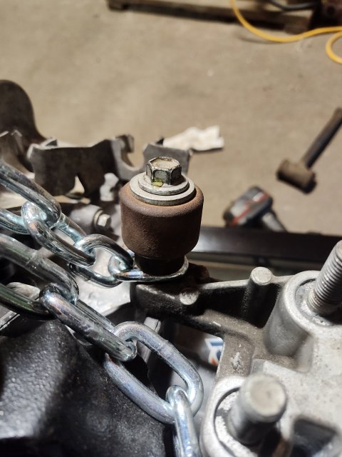

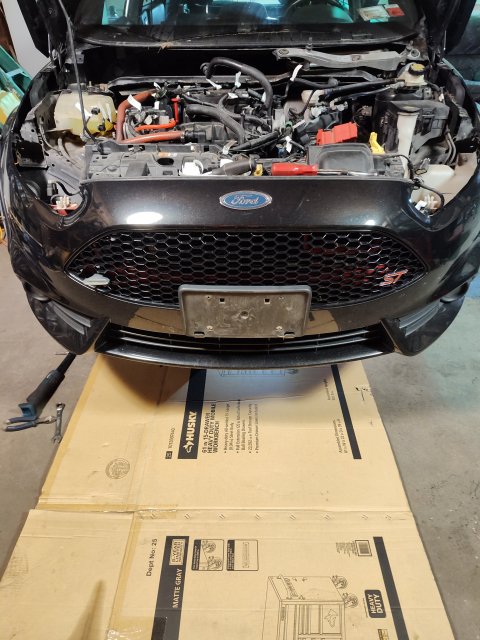

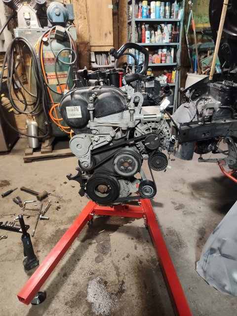

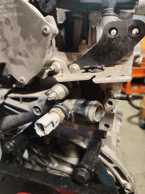

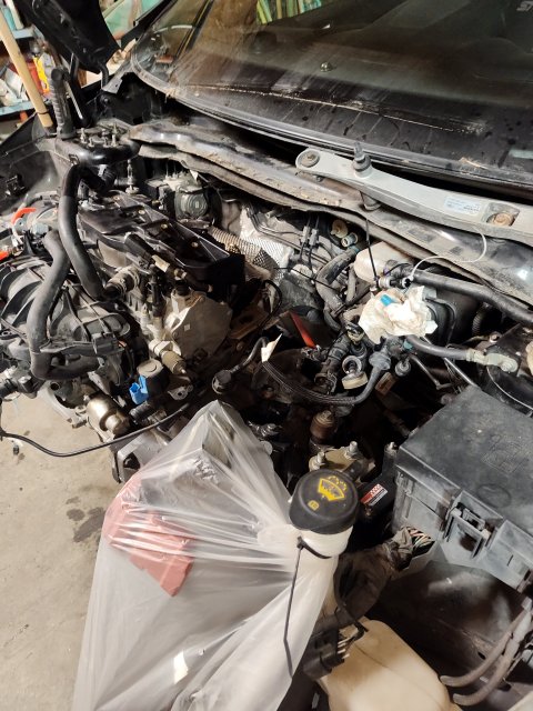

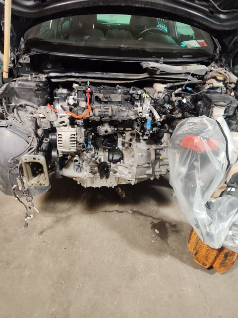

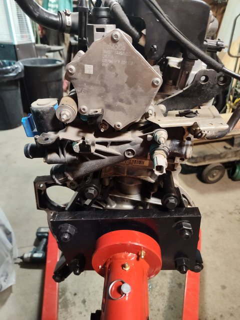

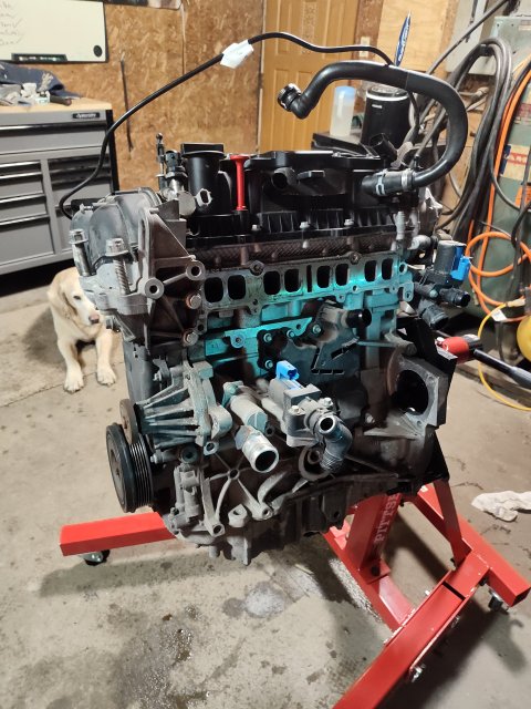

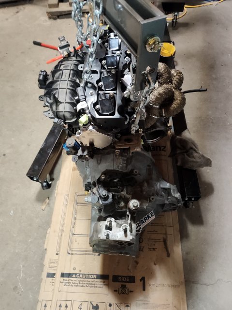

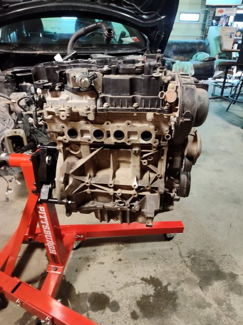

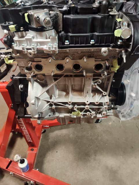

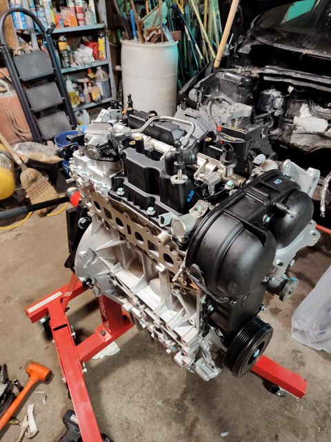

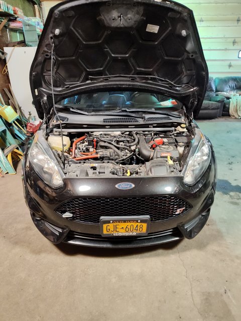

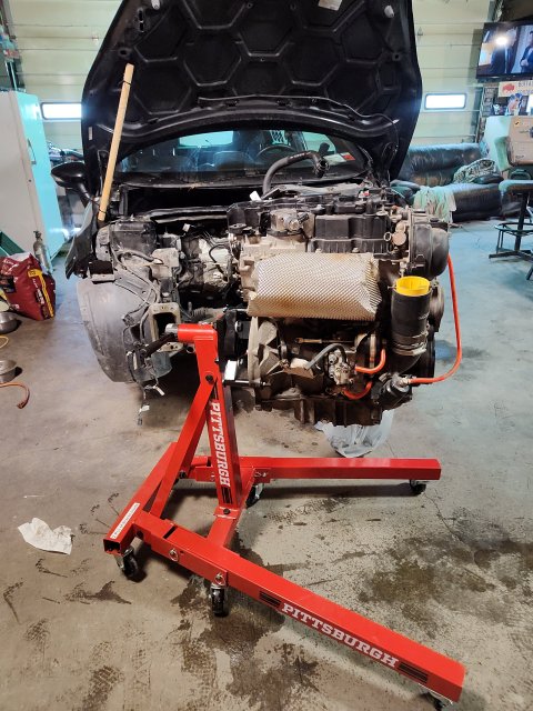

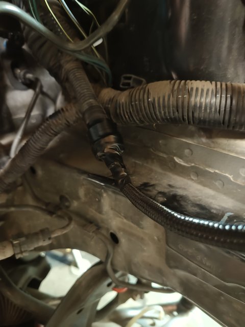

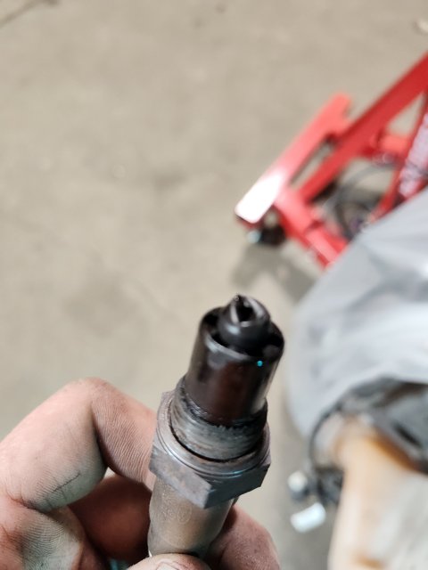

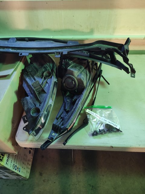

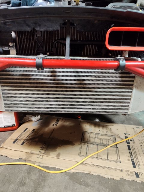

Photo dump inbound. (Attachments for mass upload)
arlisscm
379
318
Clyde
Thread Starter #70
Continued...

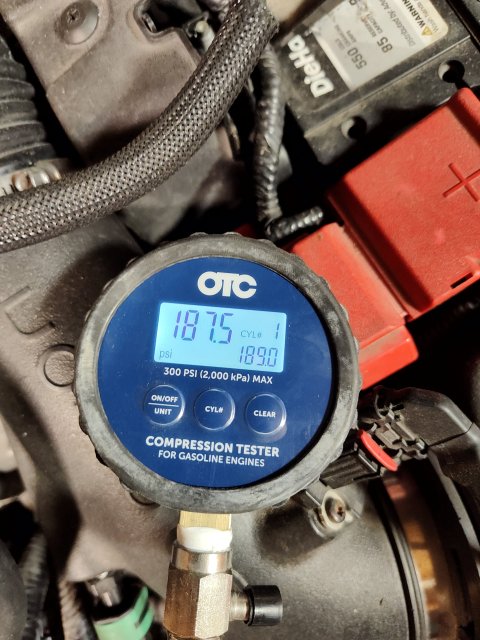

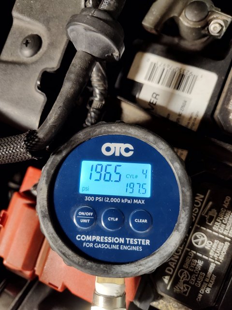

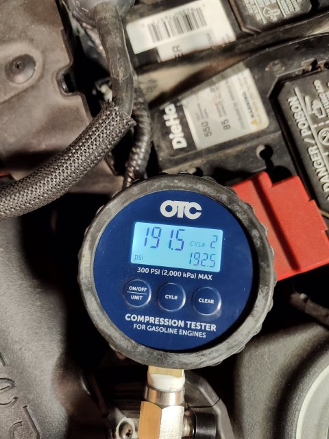

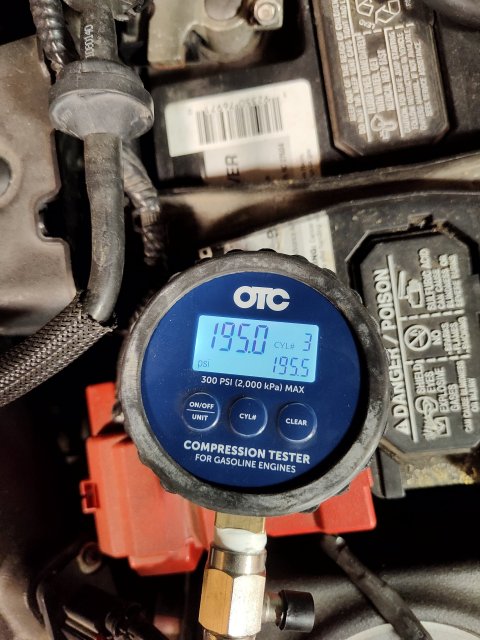

With the compression being good across all cylinders, it kinda seems like all along it was just the S280 breaking and spewing oil onto the hot cat? Or did I miss something somewhere in the thread?
arlisscm
379
318
Clyde
Thread Starter #75
Basically the same conclusion I've come to as well. Likely the overheat was really quick and from the cat being clogged with oil.
Smoke was from the oil in the exhaust (mostly cat), I have the cat-back out right now stood up in an oil drain pan to try to get most of it out before getting it running.
Seems like for the moment the built engine was unnecessary, but was inevitable anyway so no biggie on my end (wasn't hard to convince myself to dive in). Obviously still throwing it in so everything is ready for when I get some ethanol in the mix and turn the wick up.

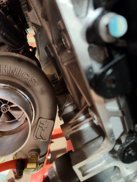

New downpipe gets delivered today, and new S280 direct from Turbo Technics tomorrow. Props to them for getting me one from the newest batch and shipping it out quick.

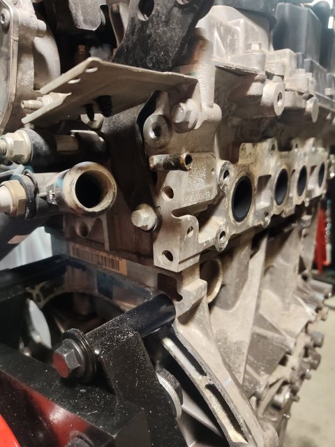

Have some lapping and clean up yet to do on my exhaust manifold (was slightly warped) and some other fiddly bits, but engine and transmission should be going back in this weekend and buttoning up as much as I can.
Barring any complications, I should have it back up and running next weekend. Then I start driving around aimlessly to do the engine break in.

Still tinkering away sorting out small installs, clean up stuff. Should have it back running this weekend. Main hurdle at the moment is sorting out mounting the oil cooler to work with my combo, but there seem to be a few places I can put it, just need to figure out the means of securing it there. Then going to add/extend the cowling/shrouding to give the air through the front no choice but to go through the cooling package. Likely to drop another batch of pictures this weekend as well.
Wanted to drop a note or two here before I forget.

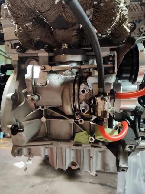

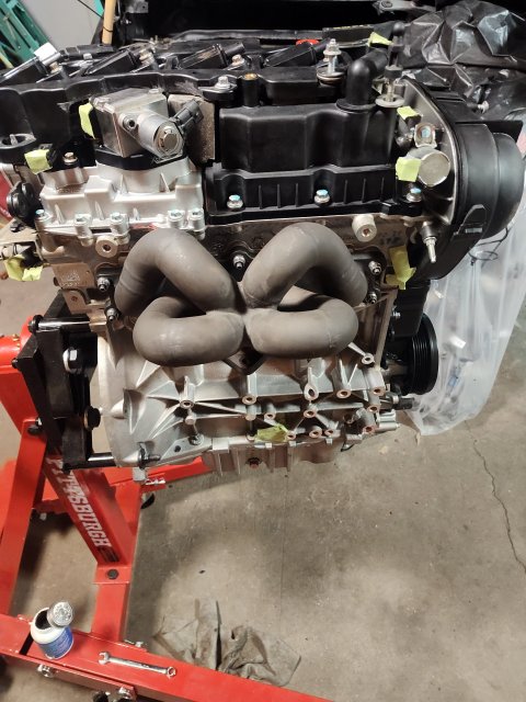

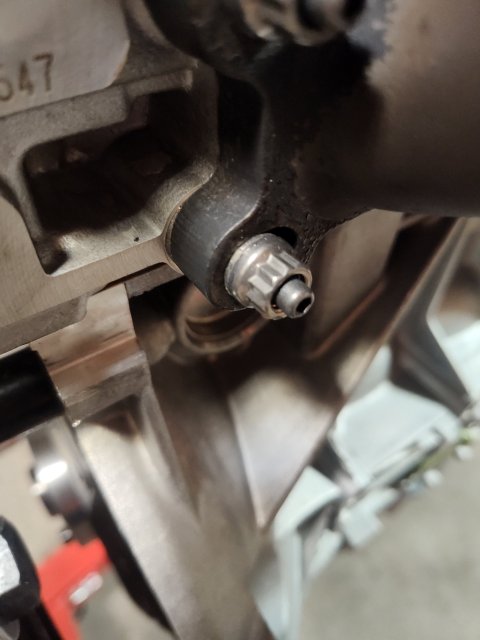

Firstly, if anyone wants to use the ARP studs for the turbo to manifold, just note that if you have an Airtec tubular manifold (maybe other "ram-horn" styles as well), you will need to shorten the rear stud (the one that threads into the turbo flange) ~.25" to be able to get a wrench on to it. Basically you need to grind off the little end nubbin that has the female hex for installation in it, and since they are 12 point, you'll want to use the closed end of the wrench. So just a slight tweak.
Secondly, for anyone wanting to run a sandwich plate with up to 2 sensors in it, you can use this Chase Bays unit that is spec'd for a 1JZ/2JZ. You will just need to trim the adapter stud (male to male stud) ~.5" so it will properly tighten down. Then you have two 1/8" NPT ports to use for whatever you want.

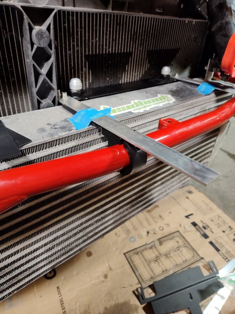

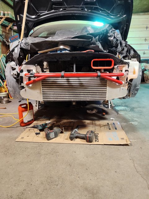

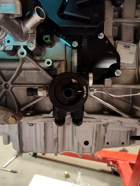

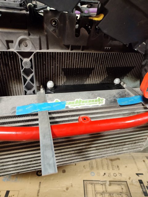

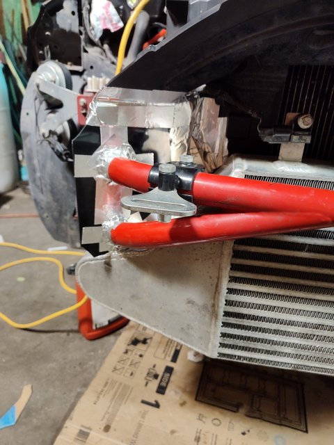

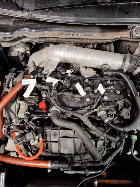

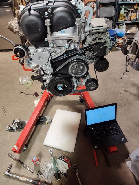

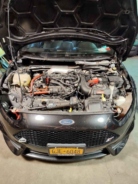

Over the weekend I got the oil cooler mounted and am working on cowling/shrouding the cooling stack in the front (basically closing off escape paths for air, forcing it to pass through IC, oil cooler, radiator) while I am waiting on a set of downpipe to turbo studs (caught up in the mail somewhere).

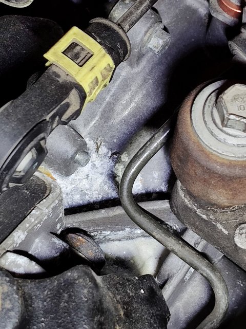

Did a pressure test on the cooling system and everything seemed good, lost ~1psi in 30 minutes (just air in the system) and left it for ~18 hours and it dropped ~9psi, but the temperature dropped a fair amount in that time with the wacky weather we are having.
Finished up the wiring for my oil pressure and temperature gauge and whipped over the engine without plugs and circulated the oil, after 2 primes I got 50psi of oil pressure cranking. Gauge seems to be working as intended, which is only surprising because I am notoriously adverse to wiring/electronics, but the install was simple enough even I did it right.
I'll try to do another picture drop this evening, I've been slacking on that part.
Basically just a few last things to clear up to cross the t's and dot the lower case j's to fire it up, check for leaks, burp the cooling system and top off the oil level after the thermostat pops on the oil cooler (should add ~1 quart according to Airtec). Then once all that is good, throw its face back on. I may regret it later, but I'm going to put some speed holes in the bumper cover between the upper and lower grills to let some more air in now with an oil cooler added to the stack. Removing the front plate/bracket opened up a little area, but I want to maximize air inlet area for future cooling capacity for when I start running some ethanol and turn the wick up a little.
If all is well and the weather holds I'm going to try to knock out at least 1/2 the 1,000 mile break in this coming week/weekend. If I have it running/driving by Wednesday, that leaves me 18 days to get 1,000 miles (at least), and 4 oil changes.

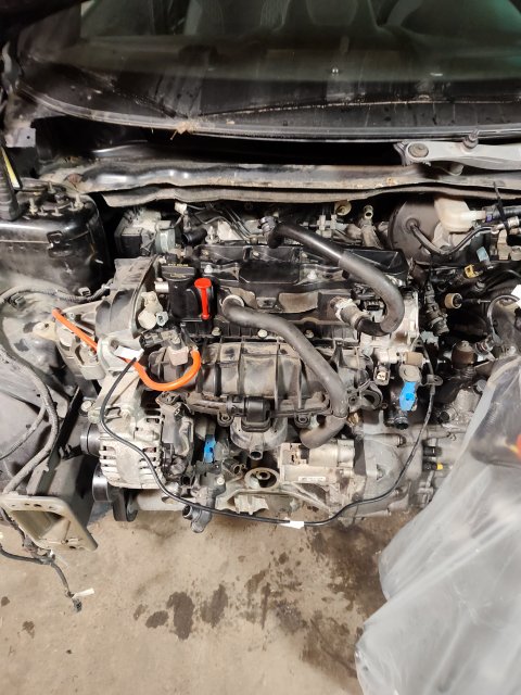

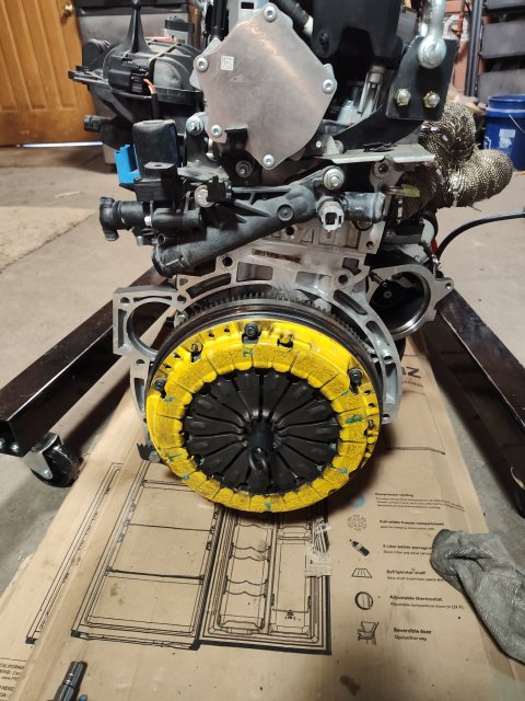

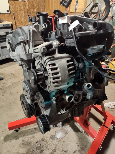

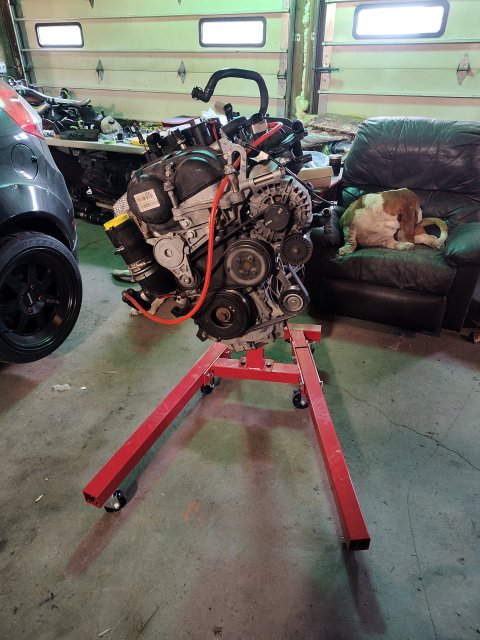

Thread Starter #79

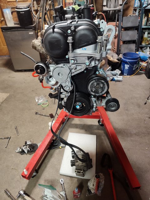

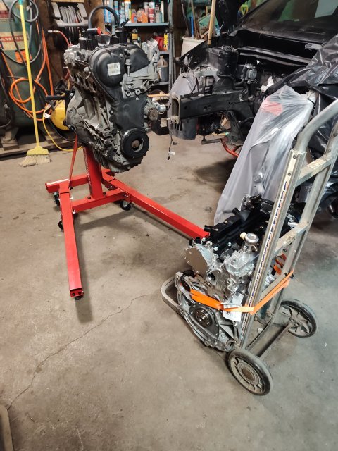

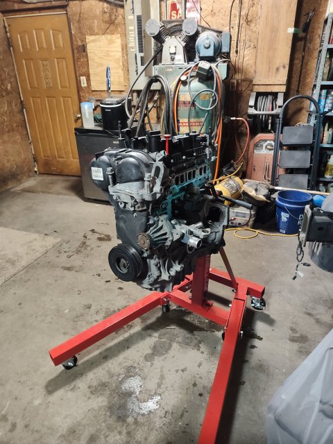

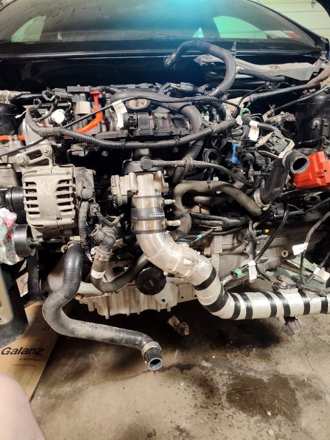

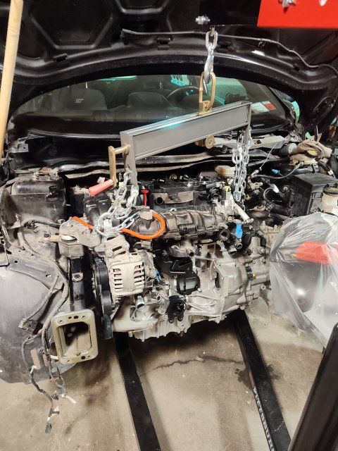

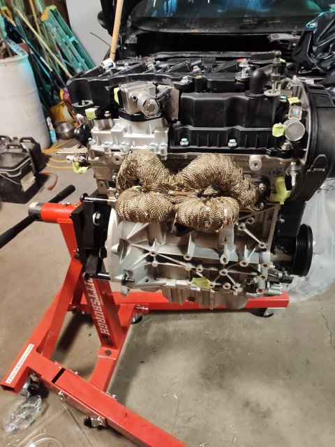

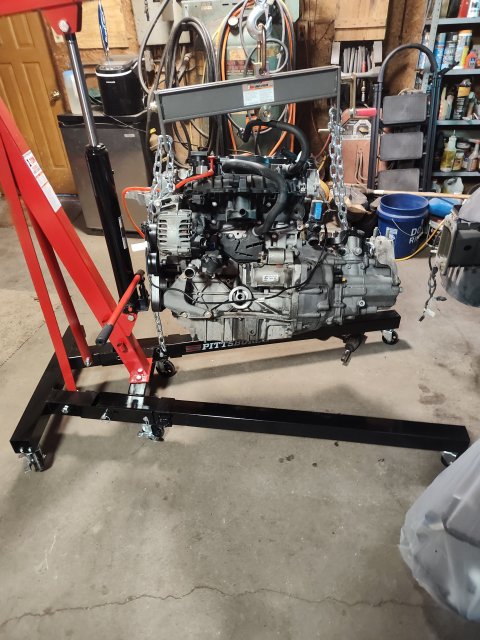

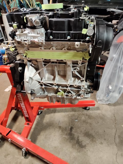

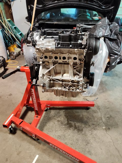

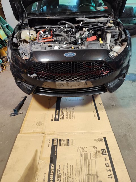

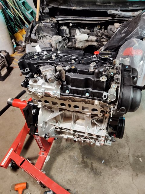

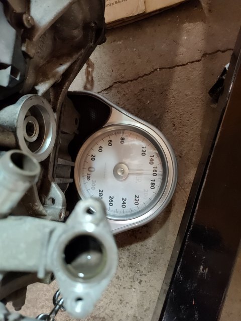

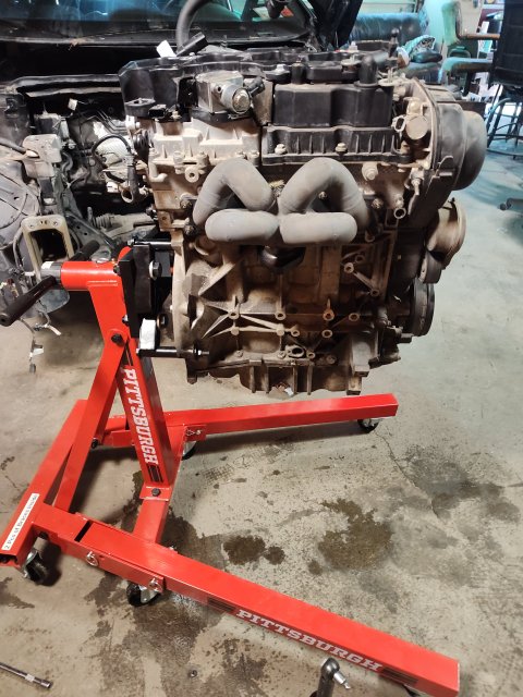

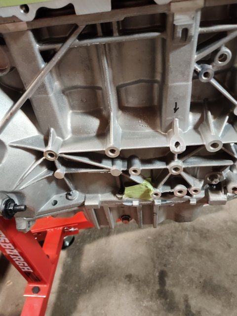

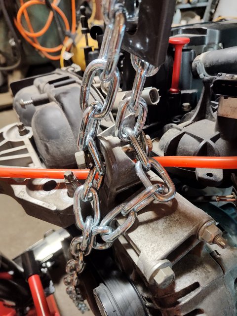

New(ish) picture drop. If anyone has any questions about anything I did or used, just let me know. Note on the weights, new engine is ~3lbs heavier than the stock one, also ~1/2 quart of oil left in the old engine, which I found out later when I laid it down and it marked its territory.
