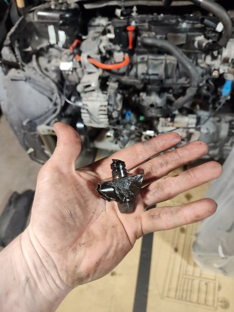

Found this in my downpipe.
Apparently my s280 exploded.
Suspect my downpipe is cooked as well, I can probably get all the oil out, but the cells are pretty beat up from the turbine wheel impact at what I can only assume was an insane speed.
Engine and transmission will be out tomorrow. I have pictures of the process I'll get uploaded later on.
