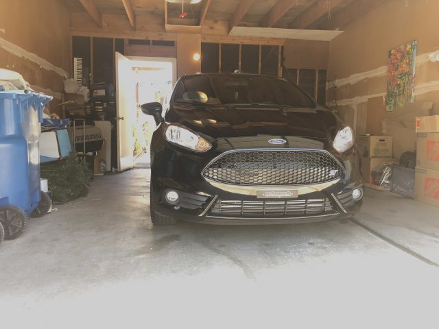

That looks amazing!! [twothumb]
What did you use in the engine bay?
Meguiar’s All Purpose Cleaner, diluted 5:1, agitated with a brush, lightly rinsed, and then sprayed with Meguiar’s Hyper Dressing diluted 5:1 While still wet. When you use hyper dressing like that, it self levels so you just spray, close the hood, and you’re done.
