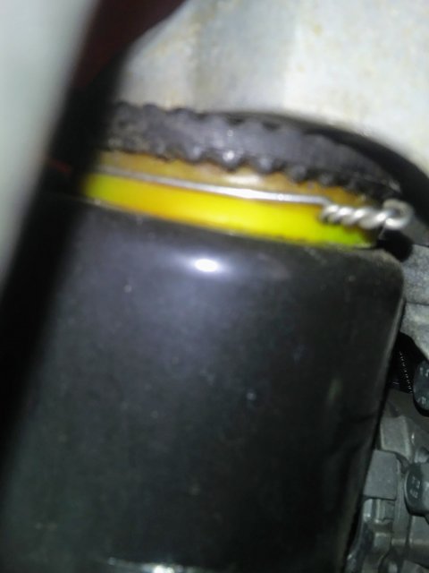

#30
I used a piece of stainless steel welding rod which was the same diameter as the o- ring. Brought it around the pineapple slice and twisted it like a twist tie on a loaf of bread. I just twisted it snug and then cut it and bent back a small amount of excess. Has held well for almost 2 years the mount has not moved out of place. 20190618_185512~3.jpg
