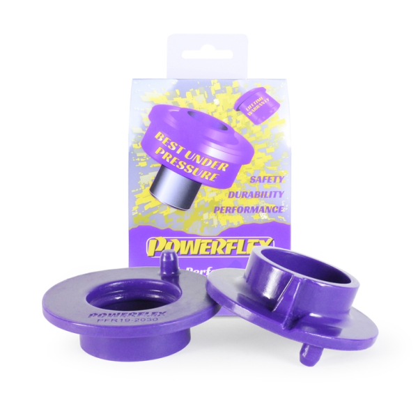

Question for @ron@whoosh: it's been a few years and it looks like Powerflex UK now has thinner, lower profile spring isolators, PN PFR19-2030. Do you stock the new low profile version, or do you stock the earlier thicker versions? Thanks.
ron@whoosh
Vendor
4,003
4,113
Las Vegas
#39
haven't seen the thinner version over here yet - it's funny though, the thickness of their rear pads is the reason we made our own
I asked Powerflex to make a thinner version years ago but after being told no, we made our version of the rear pads
