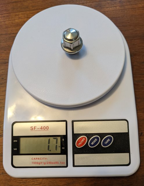

You got me curious, so I just weighed one of the stock lug nuts, and I'm sorry to tell you it's only 1.7 oz. Mine are off the car since I replaced them with aftermarket McGard spline drive lug nuts, so I just grabbed one and weighed it on a little kitchen scale I have.
That would be good weight to save because it's unsprung weight. These are the lug nuts I currently have, and they weigh 1.12 ounces each according to the manufacturer, so that would be a small weight saving-
https://mcgard.com/product/chrome-s...-4-lug-nuts-requires-65300-installation-tool/
Here is a stock lug nut on the scale-

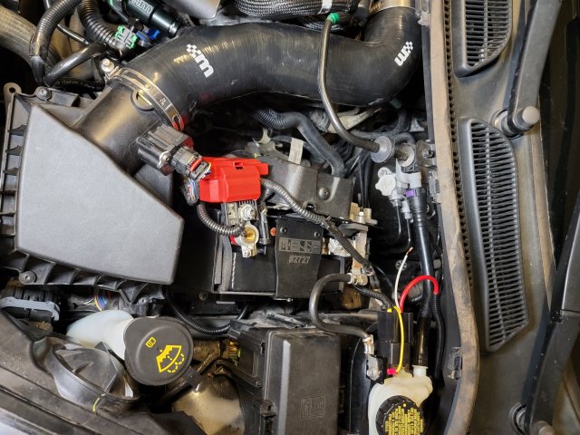

I have mine in a MeLe battery box at the stock location. The battery is Shorai LFX36L3-BS12 that weighs only about 5 pounds that I had in a Mustang before I transplanted into the Fiesta. It survived near 120F Phoenix area summer days like a champ. I had a lithium battery specific charger/maintainer for Anti-gravity (that one did not handle the heat well and swelled up before dying) but never had to use it on the Shorai unit.
At $280, saving 20+ pounds this way is much more cost effective than getting a CF hood or front crash bar (which I'll likely get after I run out of things to save weight on). I heard that lithium batteries do not do well in extreme cold, but it shouldn't be hard to get a similar sized AGM battery and just swapping them during the winter for folks in colder climate.

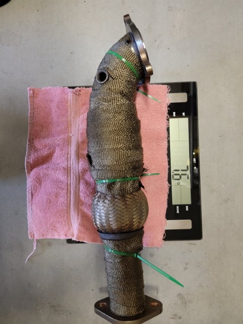

In case you are wondering, going from stock to Cobb catted downpipe saves 4 pounds:
Stock downpipe with the heat shield and bracket: 11.6 lbs
Cobb catted downpipe with header wrap: 7.6 lbs

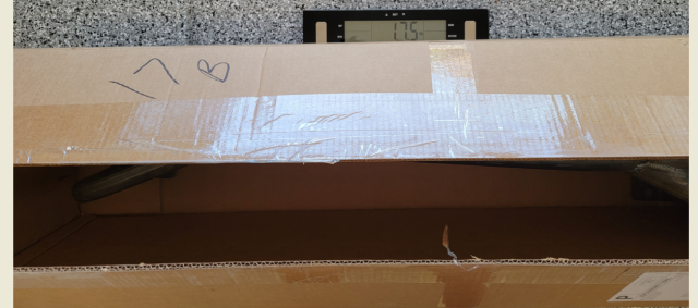

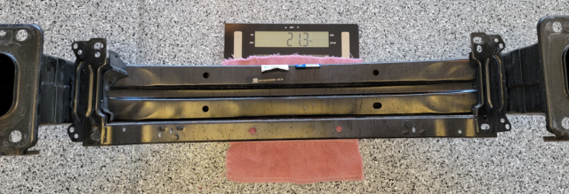

Installed the TB Performance crash bar last week.
Stock: 21.3 lbs
TB Performance w/ shipping box: 17.5 lbs
Difference: 3.8 lbs
I couldn't weigh the box by itself as my scale's not that sensitive but TB Performance's clam that their bar being 7 pounds lighter seems legit from my estimation.
