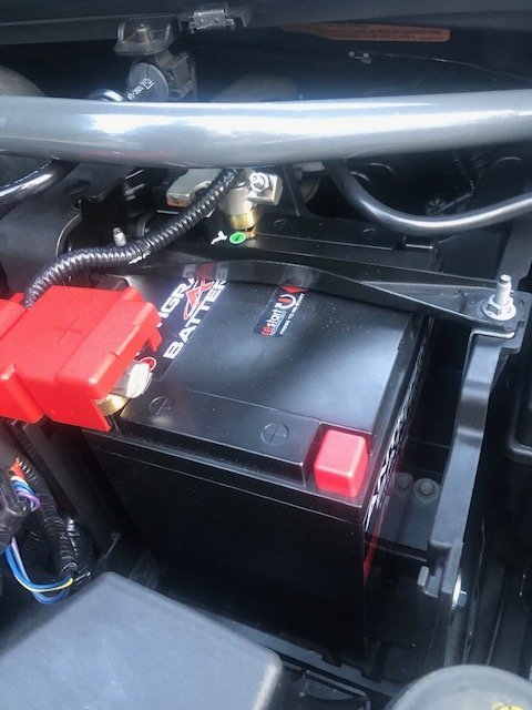

just got lithium battery installed. surprisingly it fit fairly well with stock battery tray and tie down. battery is a tad short height wise but not hard to have something thrown under there. may throw something to fill up the gap on the side.
used
Antigravity ATX30-RS Lithium RE-START Battery
https://www.amazon.com/dp/B079V4D1Z4/ref=cm_sw_r_em_api_glt_fabc_02K849YZ7HEDEK301PDW
going to get this charger, as recommended by antigravity
https://antigravitybatteries.com/products/accessories/battery/chargers/ctek-lithium-us/

Couple of notes..
I actually made a spacer tray for mine out of some kid foam flooring and punched a bunch of holes in it so not to retain heat
ATX series are somewhat heat sensitive, so it would be good to run a duct to the battery tray to get some cooling when you are in hotter temps. Get the Optimate Lithium 4s charger. Its less expensive and has run like a champ for 3years and counting for my ATX ReStart. Keep in mind that you will need to eventually take your battery out to charge, unless you use the hardwire to the battery for charging while in the car. I use my atx for pretty much fun runs and that is about it.
