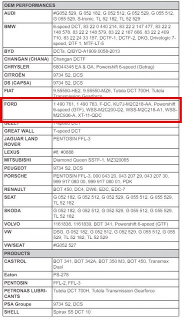

If an oil manufacturer does not include the model of your engine or transmission, would you buy their oil and assume it will work in your car? Perhaps I should put canola oil in my engine since it was used in WW2 ships. Is your transmission listed on this oil?
https://azupim01.motul.com/media/motulData/DO/base/multi_dctf_en_fr_motul_45611_20240308.pdf - I usually check their technical spec. It does not. See for yourself. maybe I missed it.
#3304
11,848
8,305
WSS-M2C200-D2 IS FOMOCO spec for our IB6 *
#30431
5
Please see their technical spec sheet from Motul. It does not include FOMOCO. https://azupim01.motul.com/media/motulData/DO/base/multi_dctf_en_fr_motul_45611_20240308.pdf
The oil this person used is only for DCT (Automatic transmission). They are not for mechanical gearboxes with an oil viscosity grade of SAE75W. It says directly in their technical spec.
MOTUL MULTI DCTF is not suitable for some mechanical gearboxes requiring gear oil with very low viscosity grade at low temperature such as SAE 75W and API GL-4. For that purpose, use MOTUL manual transmission gear oil GEAR POWER FE 75W. Before use always refer to the owner manual or handbook of the vehicle.

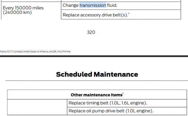

Search "(B6)" in the 2016 owner's manual.
https://owner.ford.com/tools/account/how-tos/owner-manuals/sitemap.html
Given what's been going on with our timing belts on those that are regularly driven aggressively, this may be questionable, but transmission fluid change interval is listed at 150k.
On page 241 it lists:
We have found no issue with rounding up to 2.0L fill.
(some even just fill until it starts running out of the fill hole)
On page 242 it lists:
The first serial is the specification. The second serial is the Ford part number for the Motorcraft fluid.
Re spec, reportedly,
  • WSS = 75W-80
What I have in mine is API GL-4+ spec, is full synthetic and a tad more viscous at higher temps than the stock DCT fluid.
Downside is the stuff literally has to be imported.
My change interval will be around 100k versus the recommended 150k.
Since it went in with at least 20k (likely much more) on the stock stuff, it'll be some time before I'll want to swap it out again.
