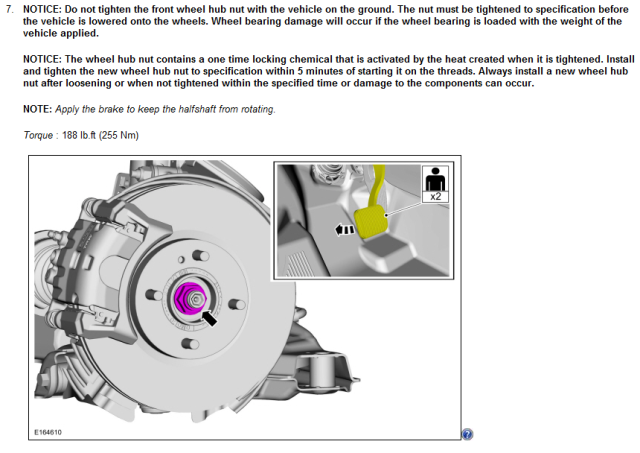

Please nobody listen to this. Torque spec for the axle nuts is 188ft lbs or 255nm.
This is the correct value. Several uggahduggahs from an impact gun can easily exceed 250fl-lbs. in addition the axle nuts are a type of tri-lobe locknut, and locknuts are especially bad with impact guns
4,343
2,866
EDIT 0940h: Will see if can find AXLE lug nuts in the manual.
EDIT 0943h: 188 lb ft confirmed. They recommend a new nut but implies that this is due to a thread-locker adhesive.

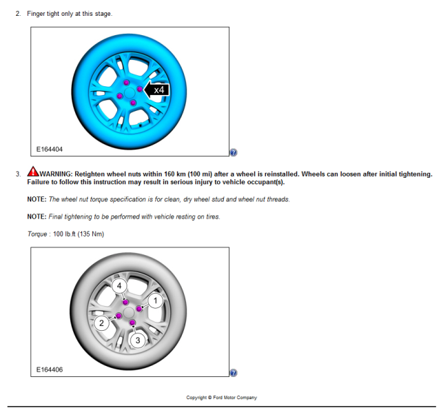

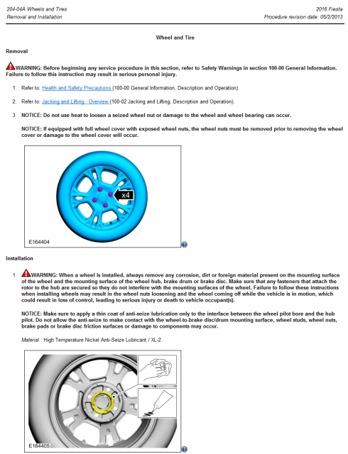

The Ford Service Manual for my 2016 Fiesta (2013 procedure revision) specifies "100 lb ft (135Nm)" and this is what I've always used. I have two sets of factory wheels.
The manual ordinarily lists different procedures for the varying options between Fiesta vehicles, but for the "Wheels and Tires" procedure, does not.
14,928
7,367
^^^TRUE on any of the factory wheels, but some aftermarket wheels state 80 or 90 lb. ft. for their specific wheels.
Since I only own aftermarket wheels currently (except for the steelie spare), I compromise/interpolate and go either 90 or 95 lb. ft. on the torque, even though all three sets (although not sure on the Dekagrams??) have those steel lug bore inserts.
