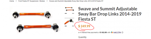

Even if they did work the bushings in them may not be the best for our application. OEM manufacturers put a lot of time into bushings when designing suspension and steering systems. In my opinion OEM control arms only.
I will give you or anyone reading this a tip. If you click on the part number on RockAuto it will show you all of the applications. I do this for everything you will quickly realize how a lot of aftermarket parts cover a much wider range than OEM parts.
Example below.

Trying to understand what stiffer/adjustable away bar end links would get you as a driver? Is it really noticeable?
