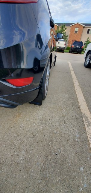

Didn't get a chance to posy it yesterday as I went from work, to shop, to home, to bed. But did the BoV, RMM, and mud flaps! Didn't get pics of two of em because I forgot, 5 hours in the shop of non-stop work will do that. But here's the mudflaps!
Jury is still out on the RMM, only drove 10 mins yesterday, but the BoV is the best thing I've done to this car, paired with the intake, it makes noises now! The BoV isn't loud unless you're slamming on it, which is what I like, and same with the intake. The mud flaps were definitely below expectations for build quality, and it seems a racoon I smacked damaged the liner on the passenger side front, making the install a pain, otherwise they look awesome!

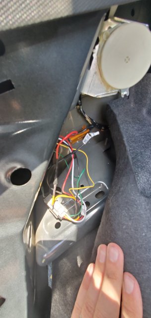

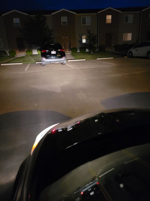

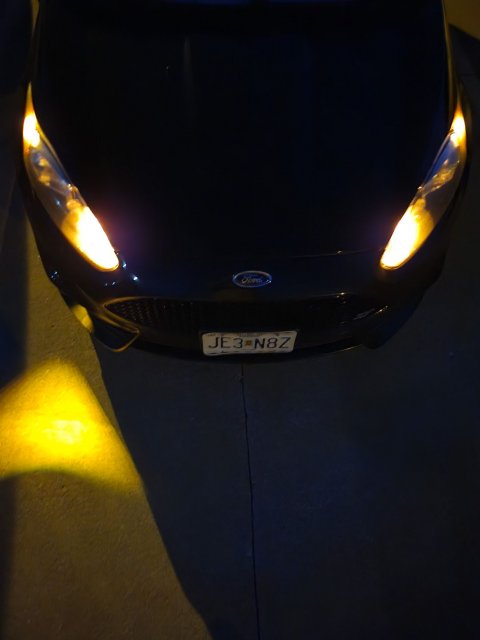

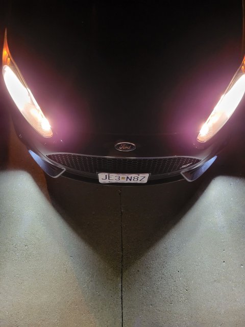

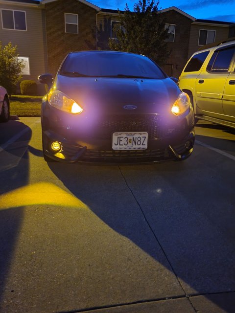

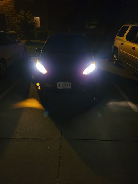

Gonna have to take more pictures soon, Whoosh V3 FMIC from Ron is set to arrive tomorrow, and I got a set of those fancy Diode Dynamic Elite Series fog lamps. I got to say they are BRIGHT, with the fogs on, I can barely see my headlights, and so far they've passed the flash test, as I haven't been flashed with them on yet. Need to get some kind of replacement for those headlights cause the fogs make them seem wimpy lol.
Had to splice into the headlamp wiring for the amber back lights, which is optional, and I goofed the driver side up and got into the wrong wire. But the passenger side looks amazing with the parking lights on and that amber backlight. Will definitely take pictures of that after I figure out the driver side wiring. Nothing stopped working, so thankful for that. Next up is likely going to be a set of Ruthenium plugs, and possibly a pro-tune, though I prefer Dyno-tunes and I heard Panda Motorworks is quite close, anyone used them for tunes before?

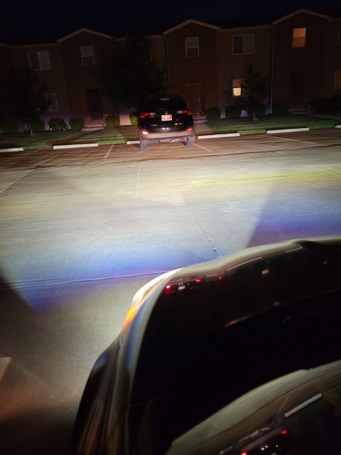

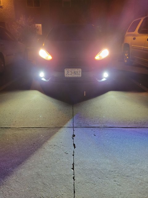

Borrowed the wife's phone so I could take pictures and show ya'll what they look like. Driver's side driving lamp is only not working cause I picked the wrong wire for the backlight function, once I get a chance to go back to the shop, I'll fix it lol. Now hopefully I'll see the racoons before they take out this pair of fog lamps!

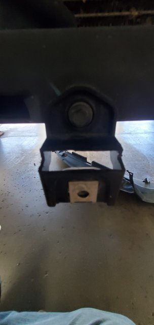

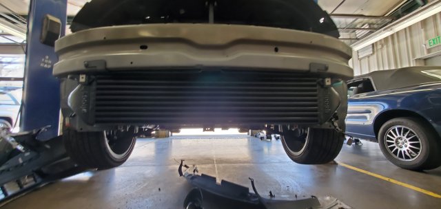

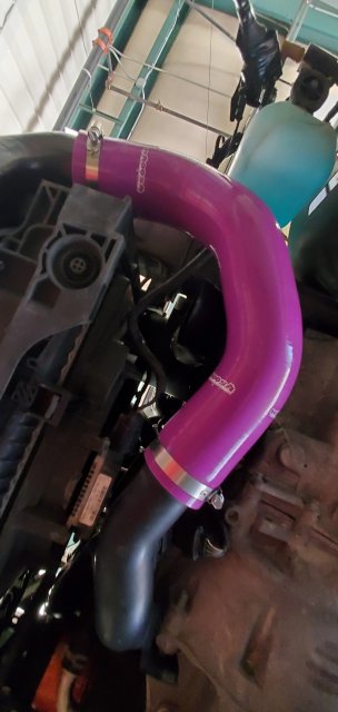

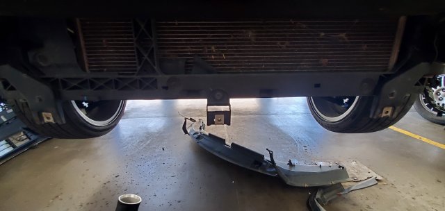

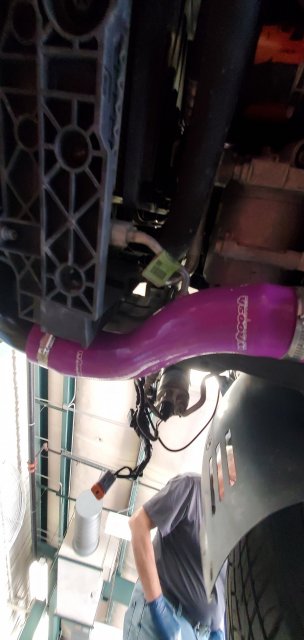

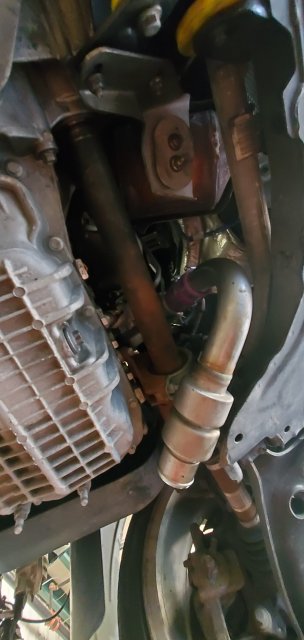

Step colder plugs and Whoosh V3 intercooler installed, along with purple boost hoses!
The air dam/mud guard(?) Middle bracket 100% will not fit with the V3 intercooler, but take a grinder to the bracket, shave off a notch where it bends down, and the IC sits happily on top of it!
Accidentally broke the sound symposer tubing because I was too rough with it, hose wouldn't pop loose, so I took a thick bolt, set of washers and a thick rubber gasket and sealed it for the time being, already ordered a symposer delete from Ron to replace my Jerry rigged piece.
Also of note, make sure you tighten the hoses good and tight, I hit 16 lbs and heard a 'thump..whoosh' brought it back to the shop and immediately found the hose off the cold charge into the intake had come loose but not off, whoops.
Right after I put in a set of Ruthenium step colder spark plugs, figured I'd see how they held up.
All said and done looks great, and performs awesome cheers again to Ron over at Whoosh motorsports.

Replace the hot side resonated piping on the intercooler for extra spooly spooly sounds ;)
On that note, yes I too have blown off hose piping. Makes quite a frightening bang when that excact pipe also slams the ground and back up into the subframe. Yes I blew it straght off the turbo :D
That purple color is actually really nice contrasting the black piping.
looks good!
as far as the charge pipes go, spraying the inside with hairspray and then immediately putting them on helps get them on easier, and gets sticky and helps them stay on.
I also ordered a 2nd clamp kit from ron and just double-clamped all the hoses (there was room everywhere except for at the turbo). maybe overkill, but i wont have to worry about blowing a hose off lol

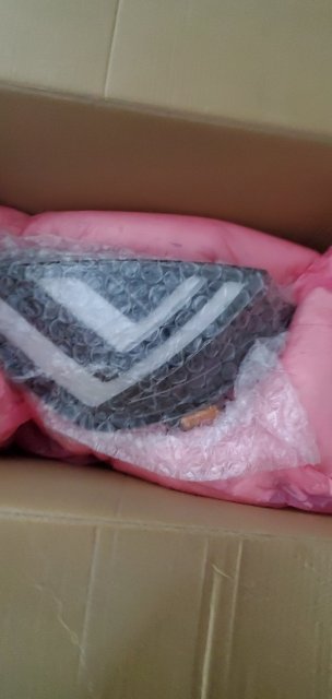

Got the Spec-d brake lights in! They look fantastic and the install is fairly simple and straightforward 20 minutes at best. Instructions say to remove the Philips head screw, to access the wiring, I found its unnecessary, and frankly, if you fully remove the trim associated, its impossible to put back, so just pull the formed carpet material down and you can access the grey tail light socket.

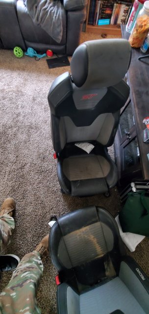

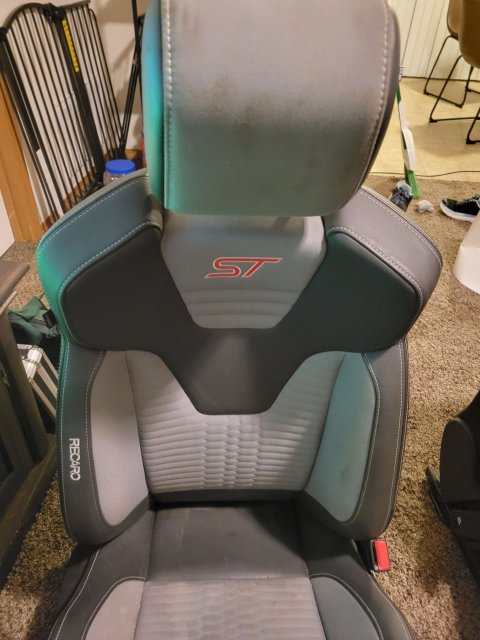

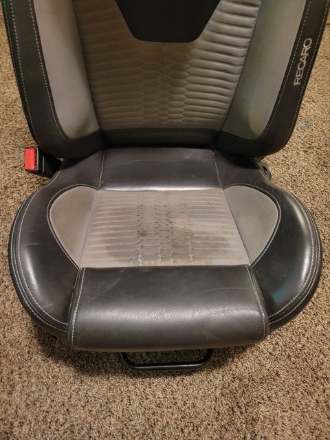

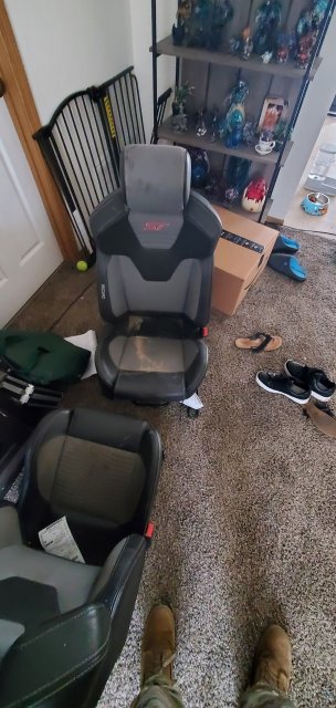

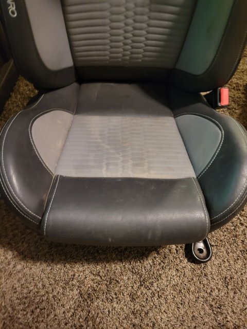

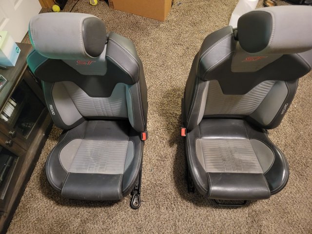

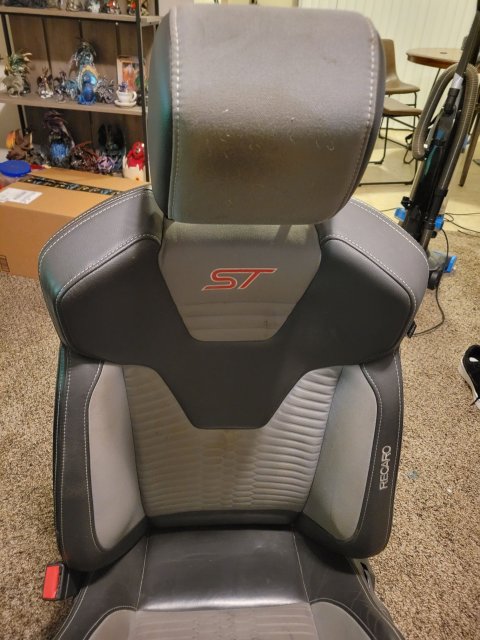

In other news, I've got Fiesta Recaros in! They're a bit rough and dirty, so any recommendations for cleaning them would be appreciated! From my knowledge 2016 FiST recaros should be plug and play, but I'll be finding out tomorrow.
Plan on swapping them in tomorrow so I can throw the cloth seats at the playtoy for the time being.

Speaking of computer shenanigans, when I slapped the Recaro seats in, the car has decided its been in an accident.
Codes: Module RCM B00A0:68-8B Occupant Classification System
Module OCS B1193 Crash event storage full and locked
Something tells me those recaros came out of a Fiesta that was in an accident, though it appears the air bags are intact.
