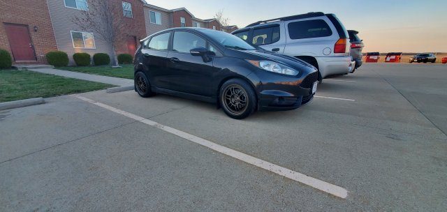

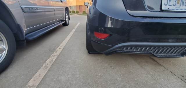

New wheels and tires are on, that's the fitment, less than in inch clearance in back so trimming will definitely be needed. Definitely gonna go with some fender rolls and taller tires in the future, need to fill that gap with thicc tires

FWIW, negative camber could get you where you need to be with fender clearance. a lot of people here buy @Dpro camber plates to get the back tires to around -2 camber (i think); it's a handling mod but the added benefit is rear fender clearance. if you wanted to do it up front you'd need to get camber bolts and/or a new adjustable top hat for you strut. camber bolts are a lot more straightforward but top hat is a lot more stout/OEM.

Good to know, I'll look into this and see if it will be enough. Especially knowing I have intentions of going to a taller tire in the future, if it fits, it ships.

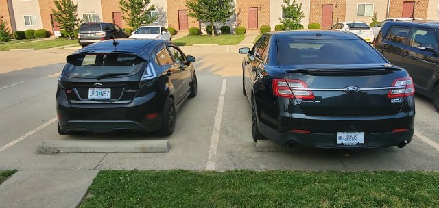

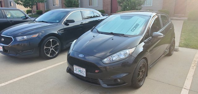

The Fiesta also got a big brother today in the form of a 2014 Taurus SHO that's replacing the wife's Hyundai. Likely to replace the G8 as a long trip car as well, given the heated and cooled seats, sunroof and all. 20230523_182712.jpg

Those are kind of rare, as I do not believe that I have ever seen one out and about in 'the wild'. [thumb]

Neither have I, actually. It's absolutely faster and more comfortable than the Fiesta, but nowhere near as fun. I prefer being able to step on it and not be in felony territory in less than 5 seconds lol

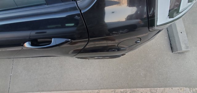

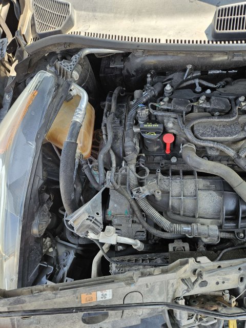

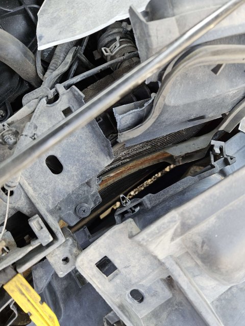

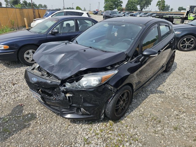

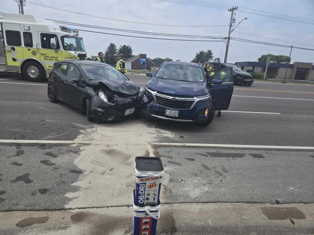

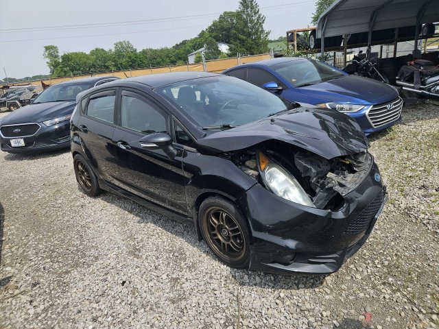

It's been a while, and sadly I only have bad news to share. The Fiesta was hit while the girlfriend was driving it while running errands since I had borrowed the Taurus since she didn't work that day. Minivan decided to gun it into traffic and smashed into an Equinox, and knocked them across three lanes of traffic into the Fiesta. No one was seriously injured, but the Fiesta is likely totaled out. Oil cooler was punctured and the radiator is toast. The engine -might- be ok, but I will likely let the insurance company take the car with the total out settlement. On the plus side, the insurance allowed me to put the stock wheels and tires, tail lights, and swap the shift knob as well before they inspected it for the total out settlement. So I will likely have all of that listed for sale once the verdict comes down.
On the bright side, I still have my pickup and G8 GT to drive, but I'm definitely going to miss my little bean, it was a blast, and I'm gonna miss it.

Ah what a bummer. Important part is no injuries, so I’d call that a win.
