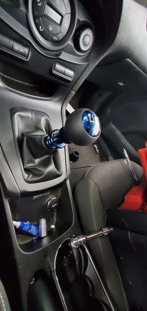

Just installed the whoosh interior bushings for the shifter and installed the Billetworkz shift knob and reverse lockout. Shifts feel just the slightest firmer, and the knob feels amazing. Only complaint is the lockout clicks inside the knob on the 2-3 if you don't have a finger pressing on the top of it.

Nice! I’ve been planning to get a billetworkz recerse lockout in the space red for some time now (I’ll do it at some point) I pass the shop like everyday on my way to work. They are cool dudes.

They make a fantastic product, if a bit pricy. But I think it was well worth the cost! I'll likely find a gasket or something similar to fit over that spot where it clicks just to get rid of it.

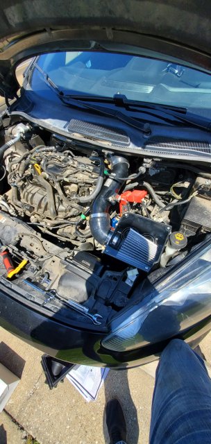

Intake and the last of the shift bushings have been installed! As well as the mud guards, BOV, and intercooler pipes, blue was out so I picked purple instead just for the hell of it!
Intake arrived today by itself sadly, as it was marked to be coming in with the Whoosh V3 FMIC, not sure if FedEx lost it or what but I'll have to make calls Tuesday to figure it out.
So far so good though, will have to wait till Wednesday or later so I can put it on a lift for the BOV and probably do the mud flaps at the same time.
