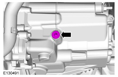

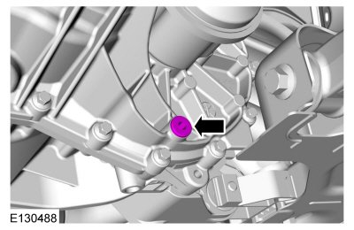

I know a search is easy and that's how I found these but for lazy people, since this thread is so helpful, nice pics of the drain and fill plug locations, 8mm hex on both, torque spec is 40 nm
