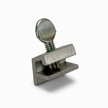

FWIW, if the trans is removed, retapping the turbo is totally doable. Ran into this issue when I was doing the LSD, clutch, etc.
Also, I’ve seen someone make a clamp w/ thick C channel & a threaded bolt… similar to how manual window locks work.
Photo is just for illustration…
