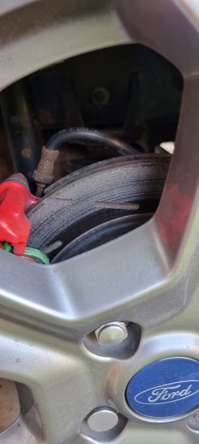

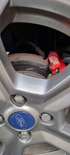

Afternoon all, I recently picked up a 2013 ST. Whilst cleaning I noticed the wear on the rear discs isn't even across its full face. The outer inch of each disc doesn't appear to make any contact with the pads. I didn't really look at this when buying, had the garage run through full vehicle check and it wasn't flagged under the issues (picked up the nearly damaged coils so they did a somewhat decent check).
I just wanted to know if this is normal or potential causes? Could it be a simple case of poorly fitted pads or do the pads on the ST fit a certain way around so could potentially have put both pads on the rear discs on the wrong side of each disc?
Car has under 30k on the clock at the moment.

The rear calipers are known to seize. Go for a drive and hammer the brakes, see if it looks any different after.

I would check the slide pins on the rear calipers and make sure they are lubed properly with silicon grease. I would actually probably get new ones and the rubber covers. Cheap insurance.

The rear pads have a metal pin that must sit in a recess in the X of the caliper piston. It it isn’t you get wear just as you show in your pictures.

Totally safe to drive. If you do it yourself, both rear pistons rotate clockwise.

figured i'd drop a reply just in case anyone stumbles over the issue and wants answers.
So the rear slider/guide pins were 100% seized, and i mean it took so serious soaking and brute force to remove them. A lot of the rear bolts around the rear brake assembly were pretty much seized in place and to add insult to the lot, the pads despite having plenty of wear on them are completely shagged, the rear plates on them disintegrated when i removed them and the rust has eating a good chunk of it.
Rather than attempting all 4 i cleaned the one i had out as i was losing daylight, put the new pins in place and assembled it back together and will pop an order in for some new pads and i think probably the rotors too as I'm not sure its worth trying to clean up the current ones. Once that and some new bolts for the calliper carrier's or the whole assembly actually arrive ill sort them all out and see how its working after! Thankfully no real driving to do.
