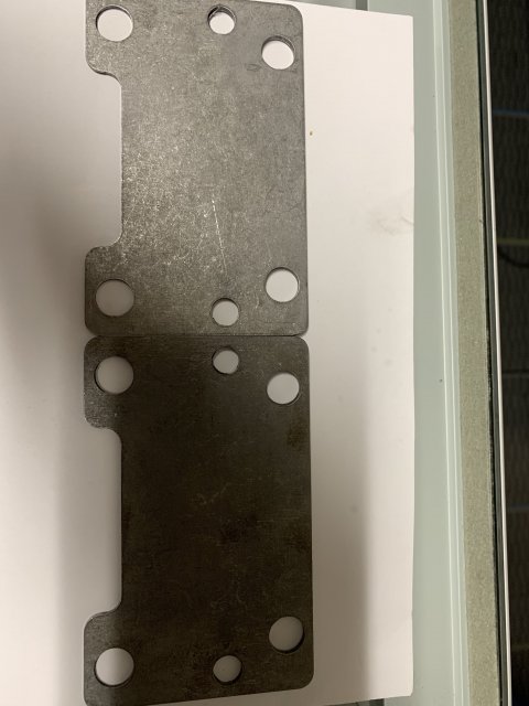

Ok guys its time. I have a run ready and I am just looking to either put a set on my car to test to see if it matters if you run the dust shield.... or someone who wants to step up and put them on their car to get the ball rolling so to speak lol.
I will have pics tomorrow afternoon and start some kind of sale thread.
#7958
6,371
6,006
Ok first pics these will $100 shipped I might consider doing a discount on the first 10 people 7EDB2468-462A-4E9D-A88B-02F4675C3E44.jpeg 7EDB2468-462A-4E9D-A88B-02F4675C3E44.jpeg

#19
ok guys gonna do a introductory special. It will be $90 shipped for the first ten buyers.
