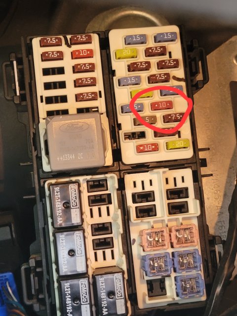

I'm trying to install some 2011 tail lights on my 2014 FieST. After slicing the wires together to adapt to the 2011 bulbs everything worked just fine... Until I installed the housing and buttoned everything up and now suddenly everything works except my reverse light. Turn signals and brake lights/parking lights all work. When I go into reverse no light, what should I look for? Thanks

It was just the fuse. Guess I shorted it while installing the housing. For reference it was this fuse behind the glove box. Couldn't find anything online to reference so hopefully helps someone from pulling every fuse like me lol 1000029987.jpg
