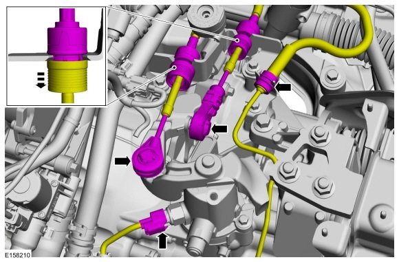

Transmission, Lower, LH Front.

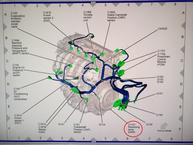

The info I posted is from the manual.
The only other image shows a connecter but it is not labeled.

Thanks, I'm not sure I understand the first photo, as it looks like it's pointing at the clutch. But it looks like I'll have to do some digging under the hood

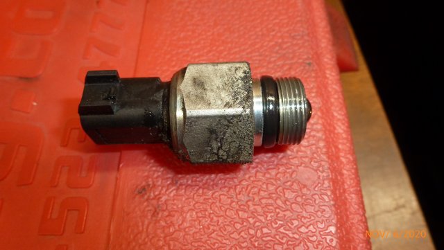

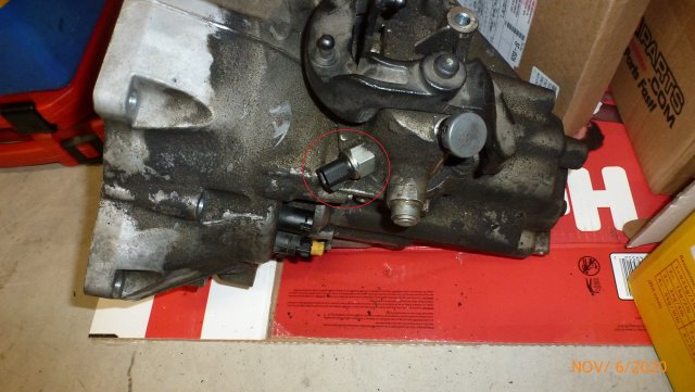

Biggest socket or wrench I have at home is a 19mm. I imagine a 22mm socket would fit. I just used an adjustable wrench to remove it. Hope the pics help...

just wanted to thank everybody for the photos. the install went smoothly but some tips for install:
  • airbox has to be removed, and removing the evap tube would've made life easier
  • clean the area before you remove the switch. I wish i did, now i'm worried about all that gunk that fell in
  • i was able to get an adjustable wrench on it, but just barely. its only needed to break it loose. can be turned the rest of the way by hand
  • it didn't have a socket that fit and it would've been nice to torque it to spec. i just turned until i could turn it no more
  • Motorcraft p/n: SW7033
