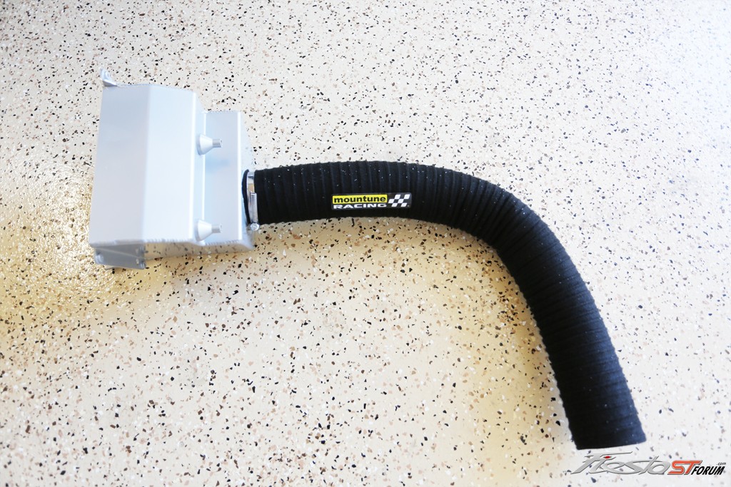

Recently I installed a RamAir intake setup on my car, and this morning I added the final piece which was the crossover pipe. I thought I'd post a few pics and thoughts. There are a few other threads on this but I like making an independent review.
Previously installed were the RamAir panel filter and induction hose. So this review reflects only the crossover pipe.

Pretty much perfect....there's plenty of room, everything goes on super easily. The pipe is touching the engine where the rubberized cover is (see pic), I think the stocker did that as well so it's no big deal, though it would be nice if they weren't touching and rubbing and all.

As you can see from the pics below, where I compare the stocker vs. Ramair, the pipe is wider and has better flow undoubtedly. So in theory more cooling ability and power. Intake air temps did drop about 1-2 degrees compared to before install. I did a datalog before install, in a few days I'll do an "after" log and compare the two and report. According to Jason's intake comparison, the crossover gave the greatest gains of any intake mods, 20tq and 4hp. I'll see how the Vdyno compares to this on my car. Of course we have different setups but still it will be nice to see the results. I will say that the butt dyno felt a bit more torque, but this might be placebo and/or happiness over my newly installed part, you know how that is. Heck though, if it really does add 4hp and 20tq it's totally worth the money. I'll post the results when I get logs after a few days. I take temps and weight and barometric pressure seriously when I V-dyno. But it's still only V-dyno...so there's really no way to prove anything here. But it helps and it's fun.
