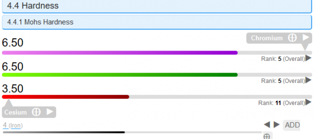

Fun facts, but arnt they using alloys, not pure metals here? Makes it a bit hard to compare them unless we know the exact properties of the alloys used.
