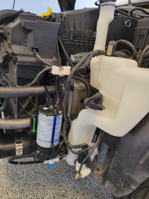

Consider water/methanol injection. It'll let you run E30 with S280 with stock injectors and HPFP. I'm using the windshield washer reservoir and mounted the pump right next to it. You can't tell it's there with the bumper cover on. You can either remove the nozzle during the inspection or mount it on the lower side of the charge pipe to also hide it.
