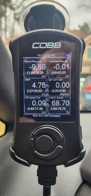

-July 2025, I contact TurboSmart regarding the pre-load on the wastegate and the installing shop owner and I put it in the air check the pre-load noting it might be off, and put a couple turns on the actuator rod, and I after speaking to Turbosmart I switch to monitoring the WGA duty cycle in the Accessport to verify that it's working and I can see the duty cycle apparently working. With the adjustments at the rod the car makes 18psi, but again does not respond to any tunes.

We have now confirmed that all the routing on the boost control solenoid is correct, we have confirmed the pre-load on the wastegate twice, we have replaced the boost control solenoid, we have leak tested the car multiple times, I have replaced the wastegate, we have replaced the vacuum lines on the boost control solenoid, we have put the car back on an original base map, I have tried different tunes and different maps, I have replaced the BOV and personally watched the Accessport command changes to the wastegate duty cycle in the Accessport, and we seem to have a nominal voltages coming from the harness to the BCS, and the BCS triggers a code when unplugged suggesting the circuit is operational. On the new wastegate the car is once again only making 14psi, and not responding to tunes. The turbo has been tested with the wastegate capped and makes 27psi when it is run in that condition, and I can hear it audibly spooling when I've been driving it around and can feel it coming on at whatever the wastegate spring pressure is set to. Fundamentally it seems as though the BCS is not getting any kind of reference to increase pressure to meet targets specified by the tunes, and no one can figure out why.

It honestly seems like you have covered everything, on the new waste gate did you also try locking it? If you were able to make 27psi in the turbo we know the error lies in the waste gate or BCS and not the turbo... Though you've seemingly replaced those already😩😩 what a conundrum!
Although unlikely, have you changed/upgrade the map sensor?

I have not checked the MAP sensor. I assumed I would see a check engine light if it were bad. But if it can affect the BCS it's a likely a culprit as any at this point.

It honestly has me wondering if there isn't some sensor that isn't overriding the operation of the BCS. At this point I'm getting genuinely concerned because even the people who really should know appear to be stumped.
