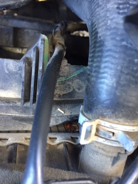

there it is, the hose and clamp are bone dry nothing but dry dust when i touched under it. but you can see the spot of pink goo now i used a stick to move the foam that was blocking the view.

one last thing are you guys able to move your radiator back and forth a little bit i do have about an half inch of play and in the bottom left of the picture you can see the gap between the radiator and fan shroud is a small gap but on my car it gets larger to like 1 inch wide the more you go to the passenger side, not sure if i am missing a clamp or clip or something that holds the radiator in more firmly??

I can't really determine much from that picture. If you're not positive where the coolant is coming from, I would consider cleaning the area with water and seeing if the pool forms again. I would also consider sliding the hose clamp back and thoroughly examining the hose too.

great idea i will try cleaning it up with a toothbrush and see if that spot comes back. it is very hard to see and get a good photo of it. the hose was super dry and had dust all around it i am fairly confident that is not the source. im guessing either its a direct hole or the seam right above the pink spot is what comes to mind.
