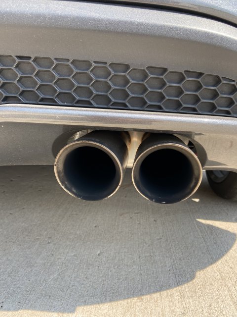

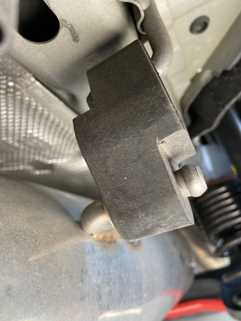

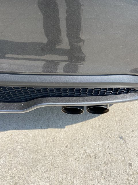

For my Mountune cat back, I used the the Whoosh hangers up front and modified a set of Mountune Focus RS hangers for the muffler. I like how my muffler sits, and think it looks good. BA24B456-22C3-41E4-95D6-556CB4CE78CC.jpeg 8751156A-6B63-4B6B-9AC9-2EE2E0BAF18A.jpeg 090EFE57-E7C2-4D8F-929E-3B1ED76C0C3D.jpeg

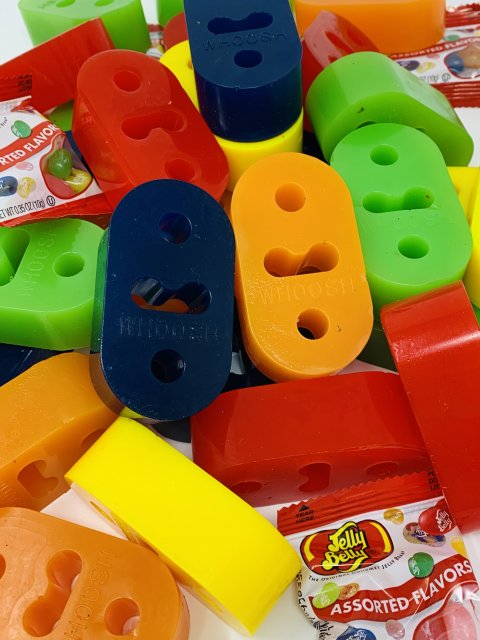

aside from the new Mountune hangers which I do not have any experience with since revised in 2020
a few years ago they sold the Ford RS euro hanger (yellow) which were nice but $39 each lol
Torque Solution / COBB = same thing. Torque copied COBB but the shape and center to center measurement is a bit shorter than OEM and are hard are hard as a rock
Powerflex is the same center to center hole measurement as OEM but they rip from heavier exhausts (warrantied many) + are much softer than Torque/COBB. Maybe a bit too soft / almost like OEM that defeats the purpose of upgrading hangers for less movement
our hangers were ONLY created from the complaints of size and failures from the other options
whoosh hangers are the same as OEM length and fall right in the middle of the Torque/COBB & Powerflex in terms of polurethane durometer
Priced lower than any others as well
We're over 3000 hangers sold to date and are the preferred hanger for some other companies like Tune+ for their titanium exhaust kits(y)

I use two modified Mountune Focus RS hangers on the Mountune muffler and two Whoosh hangers up front to help with NHV. I like the combo and the sound. The Mountune Fiesta hangers are stiff and did not line up the muffler correctly. From what I read people had to bend the Mountune muffler hangers to get them to fit correctly. I tried that unsuccessfully. I took a chance with the Focus RS hangers and it paid off (I got them for free with my Mountune points, so no loss if they did not work). I also replaced the cheap collar bolts with Grade 8. I really like my Mountune exhaust, but it was a hassle and took me 5 tries to get it right. Twisting the exhaust tubes and trying different positions could not get the muffler to set correctly. I really like my exhaust, but it might not be worth the hassle for some and I would not do it again if I got another FIST.
